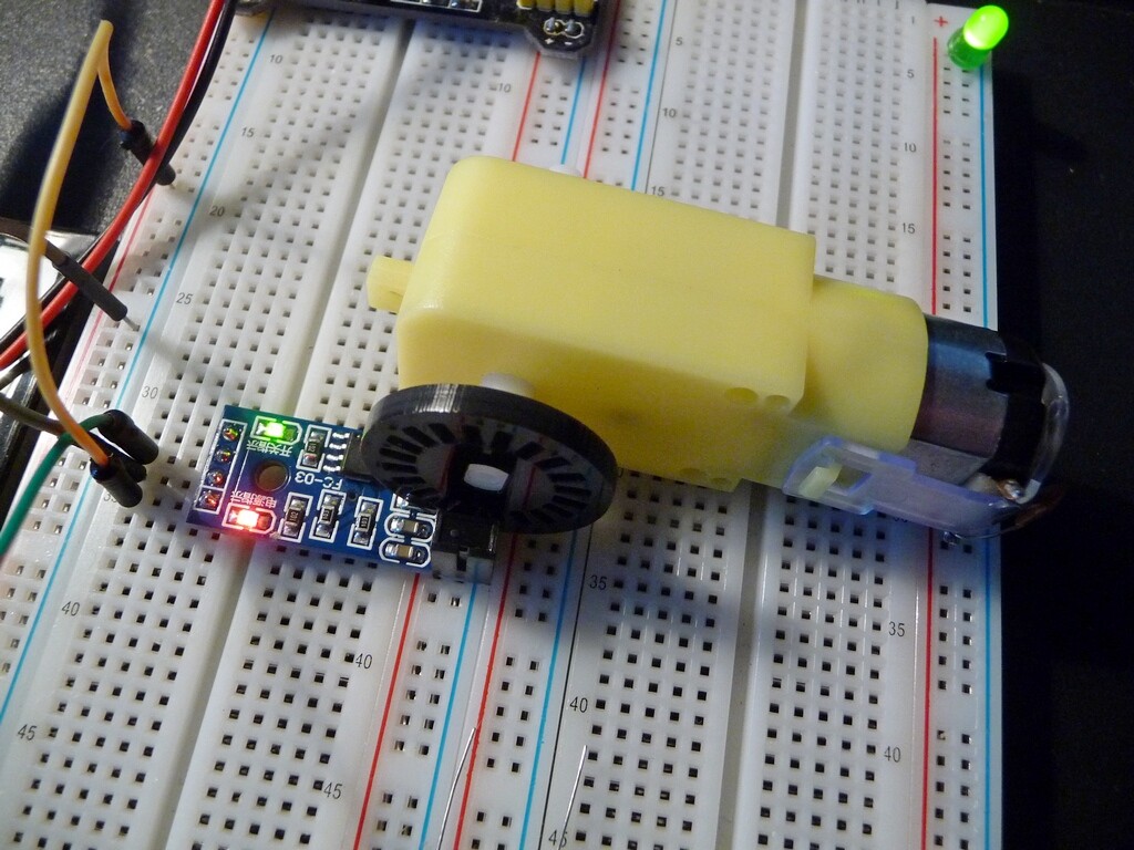

Hoping someone can help with what seems like a simple problem!! I am hoping to use 2 slotted opto switch modules of the cheap Chinese type (See pictures). To help me control my robots turning, if I use a delay the turning angle varies with battery level, fully battery over 90 degs, flat batts 45ish deg. So I got a couple of those cheapy motors with 20 slot so called encloders, but it's just a slotted disk.
My code compiles, but does not work! and I can't see why! it does'nt seem to matter if I say A==1 or A==0 as it should work both ways (I think), its like the fuction AddIt never gets called. I did try using do-while but I just count'ent get that to compile.
Here's a couple of pics to show what I'm doing, hope you can point me in the right direction.

int led=13,in1=1,in2=2,Count,A;
	// initialize the digital pins.
	pinMode(led,OUTPUT);
	digitalWrite(led,LOW);
        Count=0;
	while(Count<30);
		A=digitalRead(in2);
		if(A==1)
		AddIt();
void AddIt()
	++Count;
	Serial.print(" ");
	Serial.print(Count);
	Serial.print(" ");
	digitalWrite(led,HIGH);
	delay(10);

Hi All,
@Jimbo thanks for your reply. I tried your code in my function, but I still get nothing showing in ther serial monitor!! So I have to ask is my first bit of coding OK, like having a IF inside a while loop like this:
	while(Count<30);
		A=digitalRead(in2);
		if(A==1)
		AddIt(); //call a function to inc(++) Count var, and flash LED
or I did try a do-while loop but neither seem to work, it's got to be so simple that even I can't see it!!
