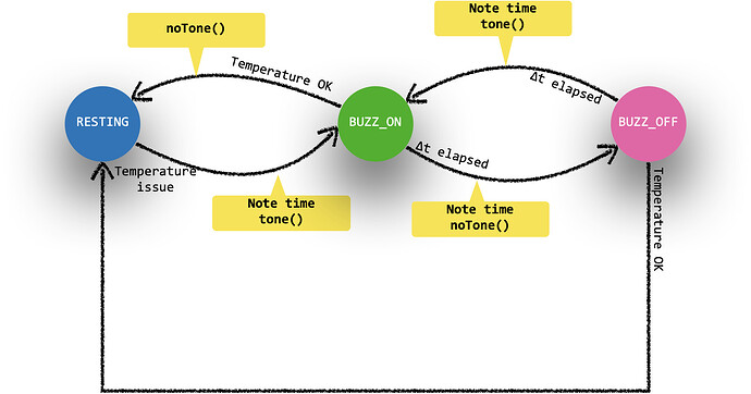

It's a smart fridge simulation, currently using a potentiometer to mimic a thermometer to tell the temperature for the fridge. When the temperature is outside of set bounds the red led should light up and the buzzer buzzes on and off. The buzzer only buzzes when I print out the variable I'm using to time it.
Sorry, I'm pretty new to Arduino, can you expand on this? Thanks!
remember the loop runs "super fast" and you keep incrementing buzzerTimer which will go negative because it's a signed int...
you should rethink the code as a state machine (Here is a small introduction to the topic: Yet another Finite State Machine introduction )
the machine would look something like this
Thanks for the diagram. I'll have a think about states and try to refactor things a bit.
