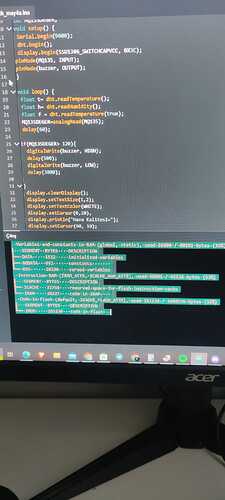

I wanted to make a device that measures air quality. I purchased the materials with the help of a video. I built the circuit. In the coding part, I did everything according to the video. I chose Done. And I got a screen like this. I don't know what to do because I am so ignorant. (a project I prepared for homework)

All codes are here. My problem is the error in the output part of the first photo.

That appears to be a message showing the details of a successful compilation. I see the same message when I compile the posted code for my esp8266.
Have you up loaded the code to the board?
What does the display show?
nothing happens on the screen. because i am getting error as i show in first photo.

Why do you think the screen image you show in first photo is an error?

Variables and constants in RAM (global, static), used 28800 / 80192 bytes (35%)
║ SEGMENT BYTES DESCRIPTION
╠══ DATA 1512 initialized variables
╠══ RODATA 952 constants
╚══ BSS 26336 zeroed variables
. Instruction RAM (IRAM_ATTR, ICACHE_RAM_ATTR), used 60995 / 65536 bytes (93%)
╠══ ICACHE 32768 reserved space for flash instruction cache
╚══ IRAM 28227 code in IRAM
. Code in flash (default, ICACHE_FLASH_ATTR), used 251136 / 1048576 bytes (23%)
╚══ IROM 251136 code in flash
After writing the codes, such an article comes and nothing happens.

The code you posted compiles and uploads successfully for me.
You can confirm that by enabling in File>Preferences the checking the verbose output during compile and upload boxes.
What you post is not an error message.
"Nothing happens" is a different story.
Have used a library example from the display library to confirm that you can indeed see output on the display.
You could also change the program to use Serial output, to confirm the sensor is being read correctly.
