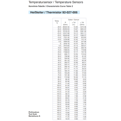

We have got a characteristic curve for the resistance of this sensor:
Yes, happily!
It has a range of resistance values not a million miles away from another sensor we heard of the other day.

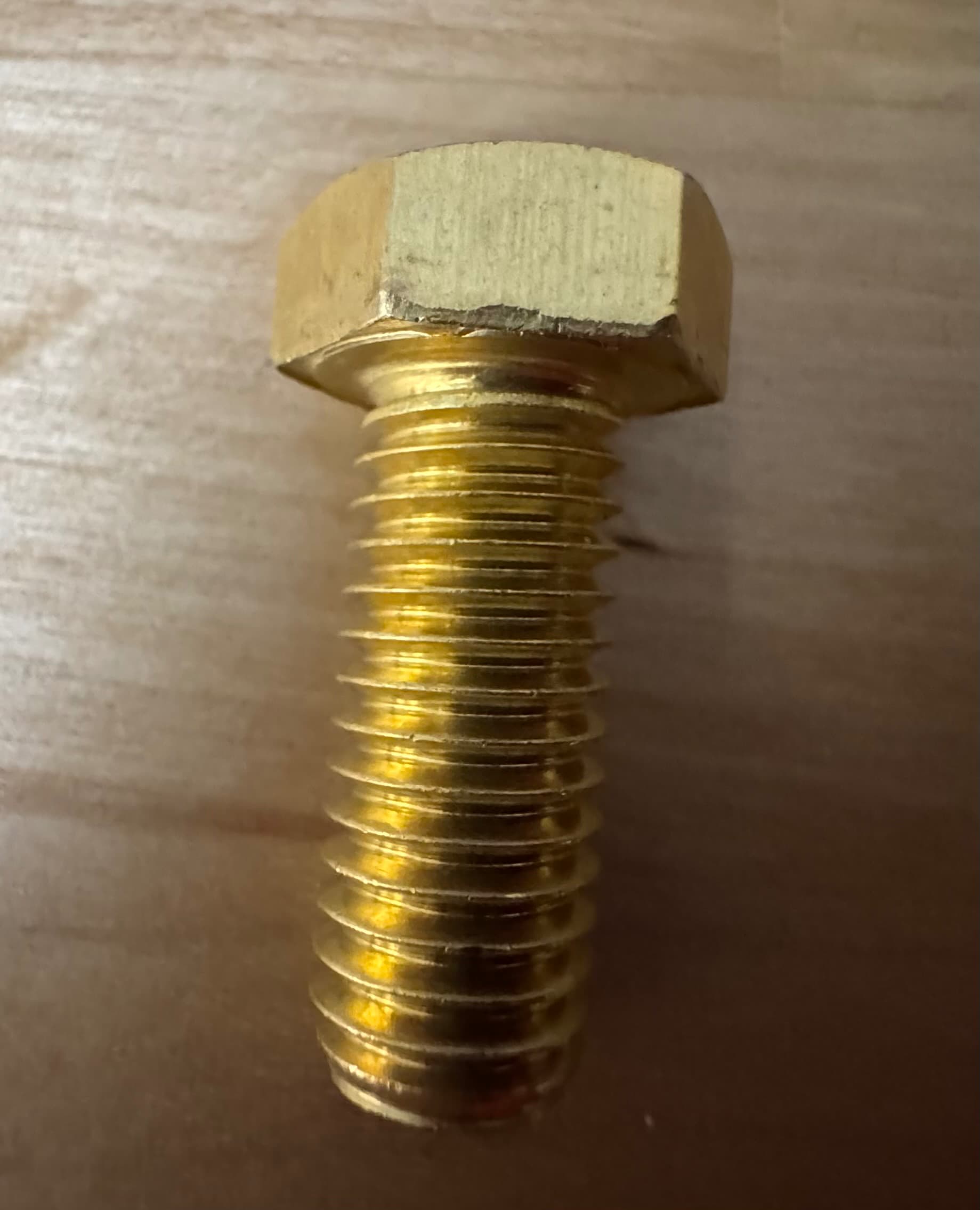

A temperature sensor with +-1ºC would be a platinum RTD. Finding one that will fit your M14 x 1.5 location might be a challenge. I just recently made a custom thermocouple sensor for a project that might give you some ideas.
I drilled a 2.05 mm hole in a brass set screw and thermal epoxied the sheathed thermocouple inside.
Since it looks like you need a shoulder for a seal, you might use a brass hex bolt and a similar RTD sensor.

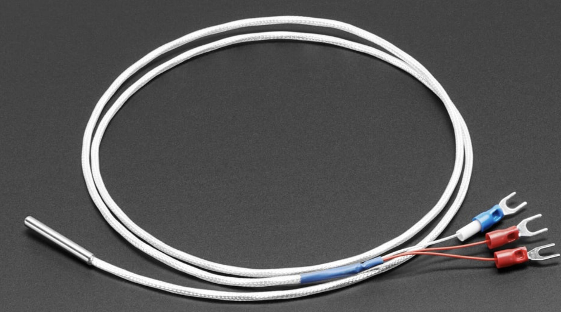

PT100/PT1000 like in the lower image is from Adafruit as well. Not 2€. though, $12.
Pt RTD
