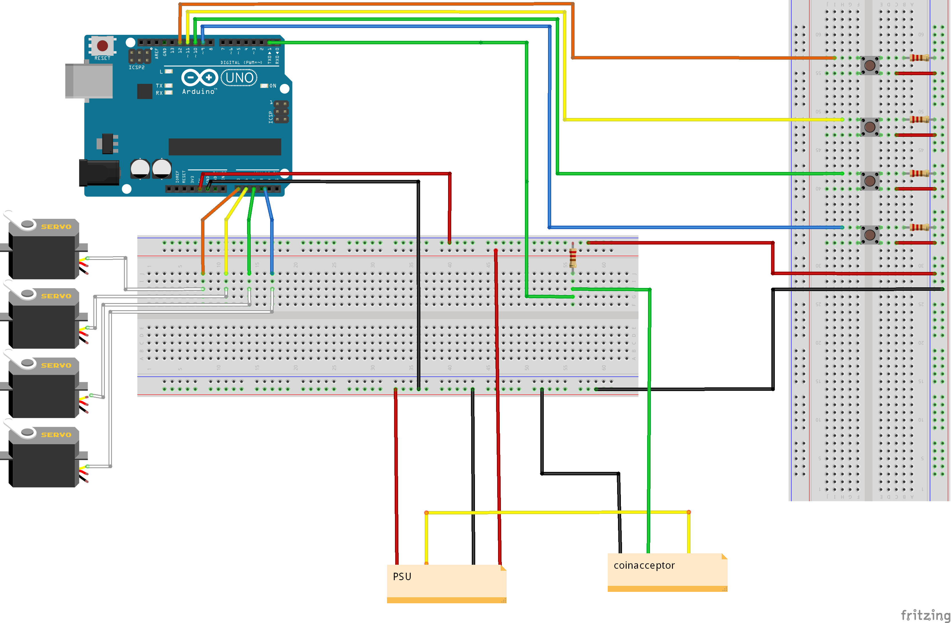

We are doing our final year project in highschool which is a venduino: a vending machine made with an arduino.
The arduino is connected to 4 push buttons, 4 continuous servo motors and a coin acceptor. The currency put in the coin acceptor is saved and when the user has enough currency they can press a button to make a servo motor rotate.
We have managed to make the components function before, but when we attached our components to the "Venduino" casing we stumbled upon a problem.
The buttons that worked perfectly before have started acting like they are pressed, when they are not.
When troubleshooting we discovered that this happened even when the buttons were not in any way connected to the arduino. Meaning that the digital pins 9-12 (our button pins) on the arduino were empty.
The project is due tomorrow and we would very much appreciate any help given! :slight_smile:

Google "floating inputs".
It's a very common noob problem.
Are you being marked on the number of lines of code you write?
Thanks! We googled it and it indeed looks to be the problem we are facing.
Arduino button tutorial
This is the tutorial we used for our buttons where there is a pull-down resistor (i think), but the buttonstate is still floating and switching between 1 and 0. Do you know why?
Just use the internal pull-ups instead. Connect the button so that it reads LOW when pressed.
I'd like to see a proper schematic, even it is a pencil drawing
Normally open momentary switch wired active LOW (low when pressed).
Typical 6mm tactile switch.
But if your diagram in your first post is a true reflection of the actual wiring, you have 2 button pins to the +ve, not one to each of +ve and -ve.
You have this:
But the tutorial is:
Thank you for your observation Hannah!
Our fritzing schematic is wrong and inaccurate and we will make sure to fix it. :sweat_smile:
