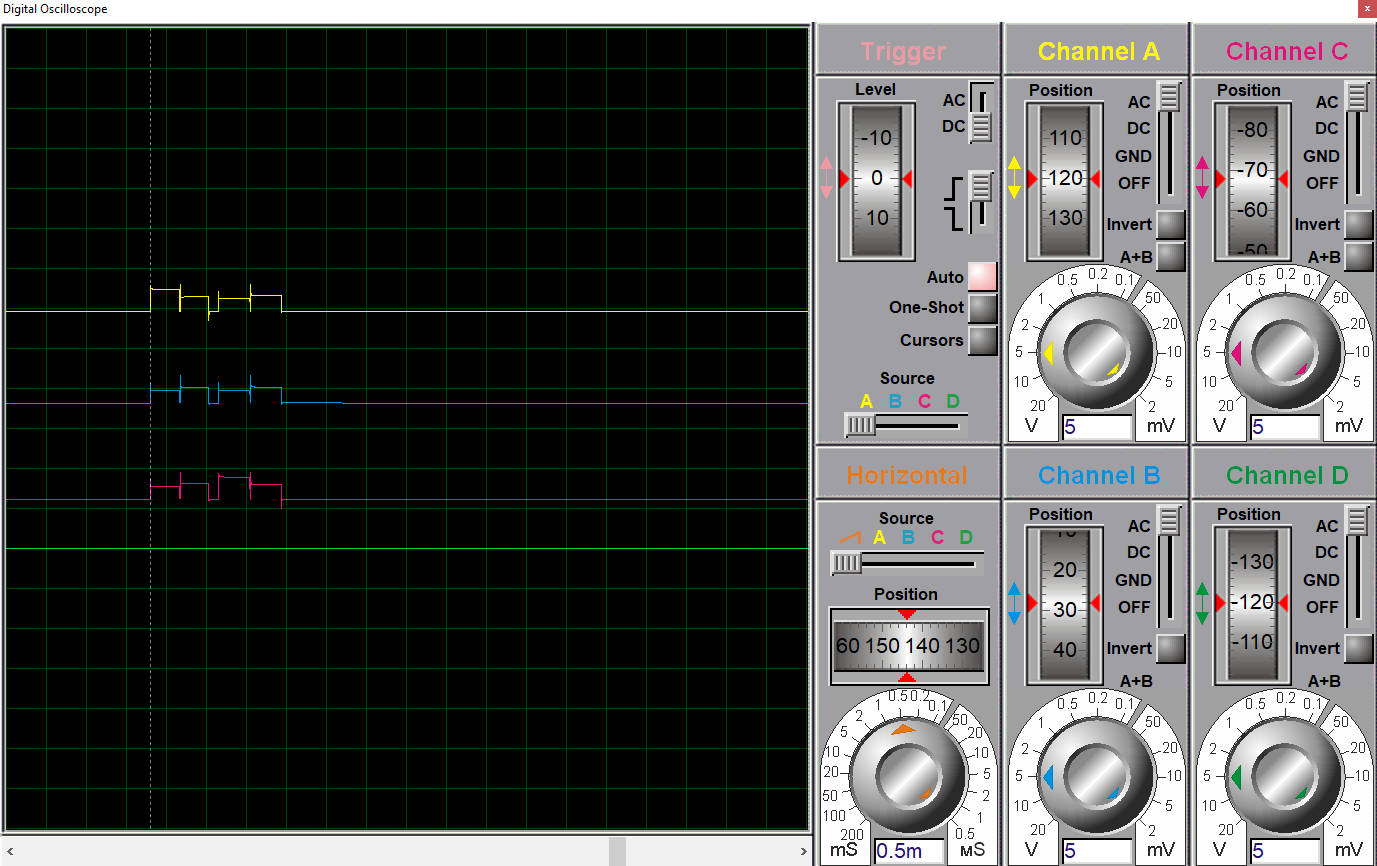

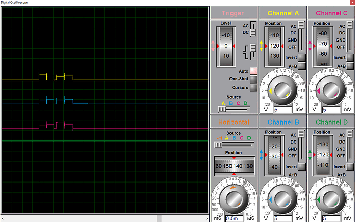

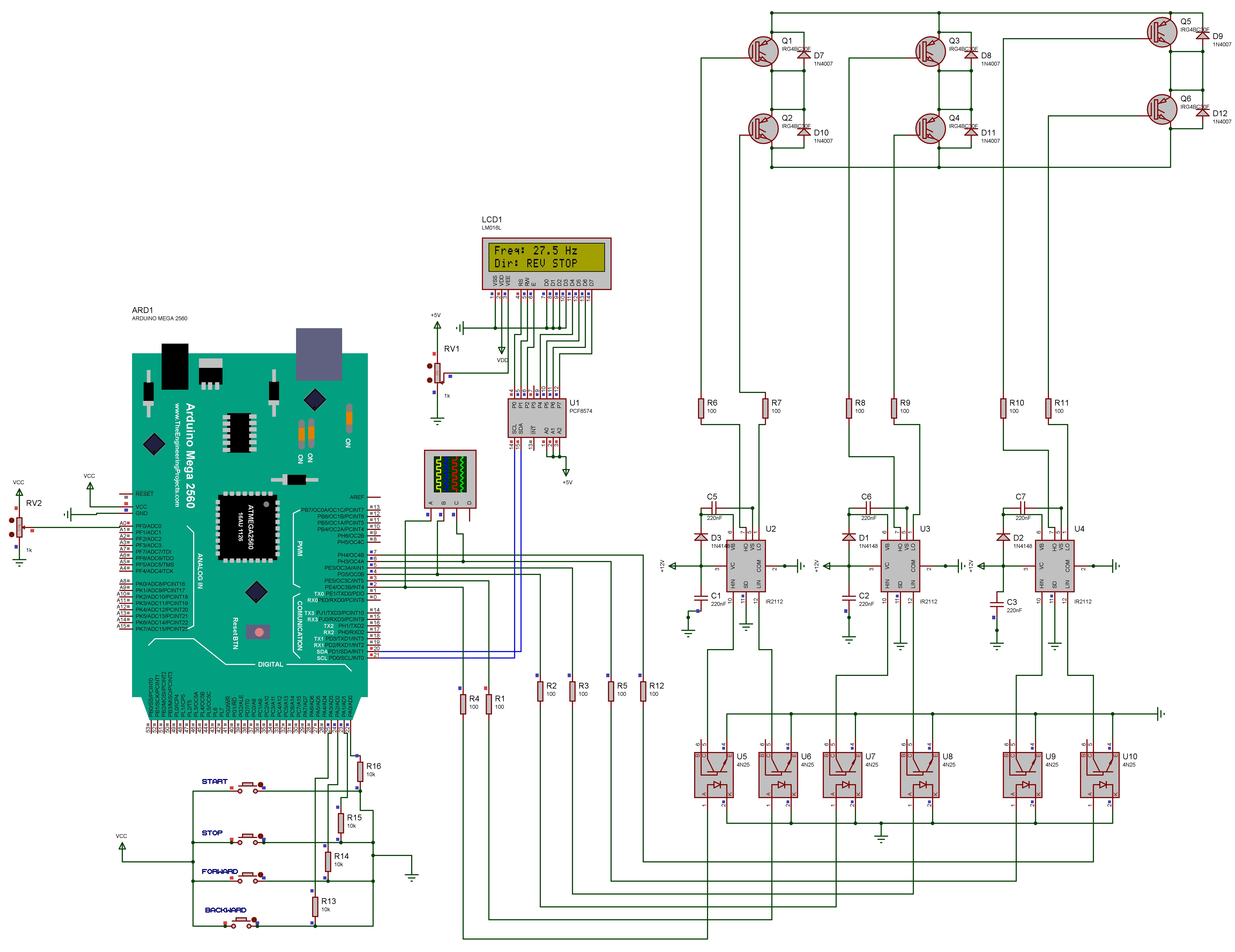

Hello , so i design this circuit about vfd , :sunny: wrote the code and the buttons are not working (only the potontionmeter) so i used a line in the code "running=true;" so the signs works ,
now there is the oscilloscope linked to the inverter and that's the sign i'm not sure its the right sign because i added a leds to make sure it works and to make it clear to you the pwm sign are work

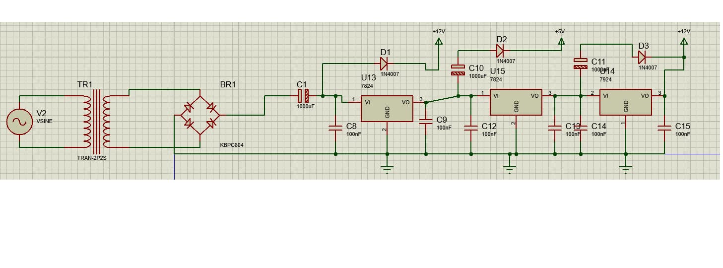

:sunny: and my final question is i know i must add the ac source and voltage regulator ... etc , is it right and if it is how i will link it to the circuit

I hope I'm wrong but, it looks like the switches (start, stop, forward, reverse) will short a power supply to ground. I do not understand how the power supply schematic can work.
i did try to that but nothing happened , but thank you for your help

Also C1 - the AC input is first rectified using the bridge rectifier then passed through a series capacitor. DC does not pass through a capacitor. If that's meant to be a smoothing capacitor then it should be connected with the positive end on the rectifier output and negative end on ground, i.e in parallel with C8.
C10 - again, you are not going to get DC +5V through a capacitor.
C11, D3 - not sure whats happening around that or how you expect getting +12V from the third regulator when you are getting +5V from the second one in the chain. I expect you do want those three regulators to be arranged in series like that?
I think you need to re-visit the design of that power supply.....
For starters, you need to learn a lot more about how capacitors are typically used. I suggest to brush up on the basics of analog electronics.
