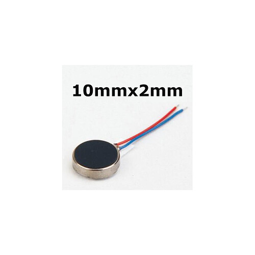

Also for the motor I bought at an electronics store so I don't have the data sheet, but here is the link for the store I bought it from

  • Measure the motor's resistance with a DMM, what do you get ?
  • What is Vce when you try to turn on the motor ?
  • Try a 220 ohm resistor.

The vibro motor supply should connect its negative to GND and positive, via a resistor, as @ LarryD says, to the positive of the power supply.
4 kOhm is maybe a bit too much. Try some 270 Ohm. That brings more power to the motor.
