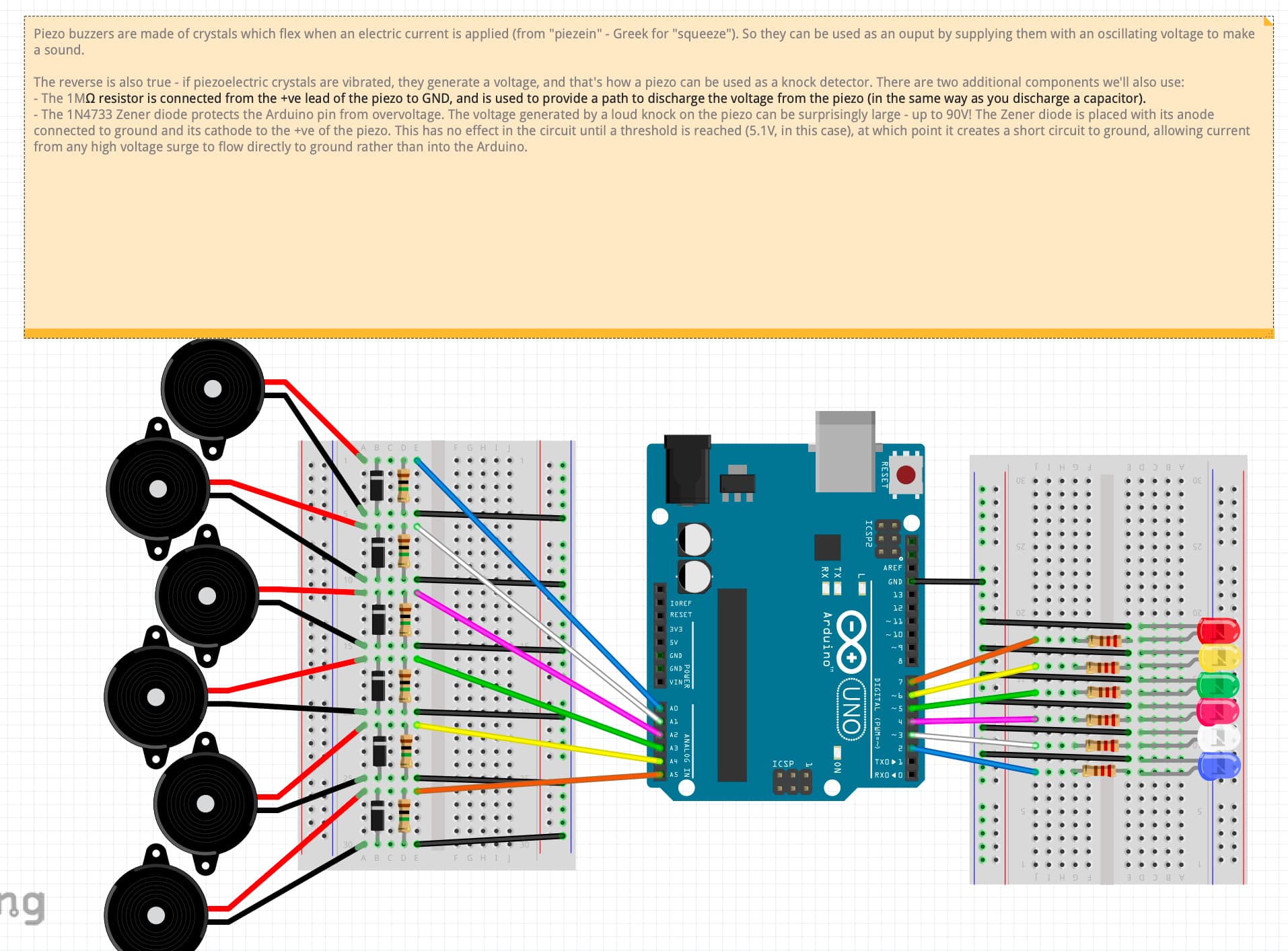

Hi everyone! I am trying to create a project using 6 piezo vibration sensors and 6 LEDs. The goal is for piezo1 to turn on LED1 for 1 second when a vibration is sensed, piezo2 blinks LED2, etc. I borrowed the wiring diagram from another project and adapted it for this.
The piezos all work great and I can see in the serial monitor the various levels of input. But no LEDs light up. Code and fritzing diagram below. I am using a Mega2560, though the diagram is with an Uno. Same pin numbers, though. Please help! TIA :slight_smile:

Maybe wrong resistor values or wiring etc.. Try the blink example with led(s) to confirm it.
I think you have it wired correctly, but a schematic would be much easier to follow than a wiring diagram.
Also, I didn’t see the rest of your code, specifically where you declared any of the LED pins as outputs. Could you share that part?
Good news: the wiring and code work wonderfully
Bad news: I'm an idiot and didn't have a ground in the right pin :woman_facepalming:
