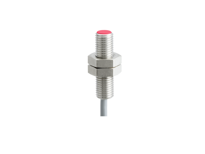

Here is the sensors data sheet. I might be unexperienced, but ti doesnt tell me much.
here it is : IGYX 08P17B3/L | Inductive proximity switch | Baumer USA

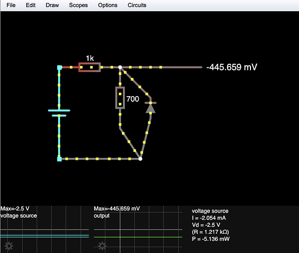

Here is the simulation I did with falstad. If I m not mistaken the maximum negative voltage that the inductive sensor can get is 2.5V ( it says that voltage drop is <2.5V in datasheet). In that case even if it the worst case scenario with schottky diode as you mentioned it is still below -500mV

Yes, the -445mV that you see in the simulation should be the drop voltage of the Schottky diode.
When you search for the diode, check the forward voltage in the datasheet. It can be anything, but make sure that it is below 0.45V.
For example, this ones: 1N5817, 1N5818 or 1N5819:
At 0.1A the forward voltage is 0.32V, 0.33V, 0.34V And I the current from your sensor will be below 200mA, so you are fine with that.
