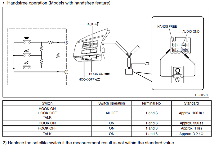

Thanks for the response guys. This is related to another thread I started, but after thinking about it a bit, I believe I got a little ahead of myself. That’s why I started a new thread because I’m not sure it’s even possible. Car SWCs (steering wheel controls) are just resistor networks that give a certain resistance for each radio function. The car radio detects a voltage level based on which circuit is completed by the series of resistors. To figure out what SWC button was press is the easy part, all you have to do is use analogRead, but my question is how do you now get the Arduino to talk the car radio? Isn't the car radio looking for a certain resistance?

@Magician, I think you might be on to something because it weird how there is a constant voltage at the input wire of the car radio. It would make sense that the radio itself has a resistor divider because when I hook my multimeter up to the Pac Audio SWI-ECL2 (allows me to control my aftermarket radio) I get higher ohms than what I get from the SWCs themselves.
Getting back to your suggestion, finding out the individual resistor isn't easy because I've been doing exactly that, trying to figure out exactly what resistors were needed that would allow me to hook my SWCs directly up to the car radio for over a week. It just doesn't make any sense.

What you are trying to build, is interface device (arduino bases) that will
get on input :
"The R-Ladder protocol is the equivalent of the CAN Bus protocol for car but with resistive transmission bus. This technology is especially dedicated to the automotive environment, using different protective methods against noise and interferences. Created to connect and interface all control units, the R-Ladder protocol offers a strong resistance to magnetic fields and other car disturbances."
and send command on output by two wire "unknown?" protocol.
If its true, you have to "hack" this digital output.
I was able to find a link, only guy make hacking with a PIC.
@Magician. Ok I followed that hackaday.com link to that guys project page. I read his entire project notes and looks like all he did was capture IR codes from a remote and dock and then he programed a PIC to sent the captured IR codes via the steering wheel controls. I also read up on the R-Ladder protocol, but I'm not sure how it relates to my project. Can you put it in layman's terms and where did you get the two images from? They look like three different resistive networks circuits for steering wheel interfaces.
This evening when I got home I explored the theory that the car radio might have a resistor divider built-in and I think it does because I was able to control the radio by place resistors between ground and the two remote wires on the car radio. Only one of the wires actually controls the mode function. The other wire controls vol. up, up, down and vol. down. How is this possible?

  1. I own a 2001 Nissan Maxima SE. This is the SWCs wiring diagram for my car.
These are SWCs wiring diagrams for a 2002 Nissan Maxima. These are more detailed and have more information. The 2001, 2002 and the 2003 Nissan Maxima’s are all the same car.

On diagram you posted, there is 5 wire interface for 2001 model,
and 2 wire one for 2002/2003.
What did you mean:
"2001, 2002 and the 2003 Nissan Maxima’s are all the same car."
Looks like it's not.
How many control/interface wires in your car, 2 or 5?
@KE7GKP, Thanks for the suggestions, I'll read up on the mux chip and programmable resistors.
@Magician, I have three control/interface wires in my car. One wire goes to ground. The 2002 and 2003 models have four wires, but that's just because they have a extra button (trip).
