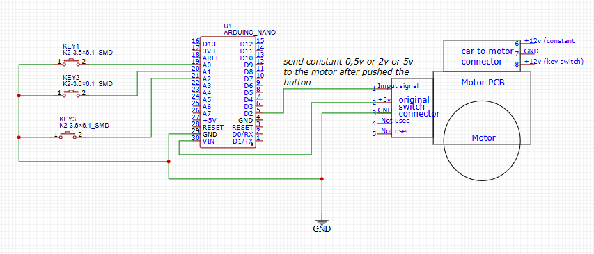

Need 0.5v, 2v and 5v same output in Nano
Hey you all, i do some customo cars and eletronics its not my deal. im building a adaptor to make a new vw sunroof with old vw switch, the old one is a push type switch, so to open you need to keep on of the 3 buttons pressed, in the new sunroof it is a rotary switch, so you put in position and its go to. i already have the old buttons sending the push to arduino, it reads the info and make a output, with analog write in pin 5 like code below.

i know that arduino don't have enough power to run this outputs. Now my problem it's how can i solve this the most simple and cheap way? i have small space for the electronics. i can use more pins if needed, but in the car motor its 1 wire for the input. so to puts 3 pins in same wire if i need, how to do this to?

If you need help here, I suggest you to post a scheme of your circuit and detailed description what you are trying to accomplish.

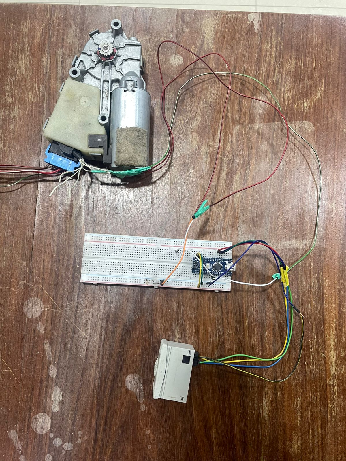

It’s not the motor, it’s the PCB of the motor that receive those 3 signals and go to position by it self.
Tomorow morning I’ll post photos of what I’m doing and a diagram for better understand

my scheme is like this.
real photo of it:
Ok so where i get the 5v from? arduino can handle the current, so need be from the motor pcb 5v, but how it trigger to send this constant voltage to the signal input? because it must be constant, not a push. hope make my self understandable
Just a little up date that i forgot to post the code im using and "works" but with not enough power to signal make the pcb of the motor to understand.

It will not because it need to keep the current, if i release the button it will send 0v and the motor pcb will move the motor to 0v position. it need to keep the voltage after i "click"/press the button and change to other voltage when i press the other button.
but you are right it need true analog signal, so thats my question, how can i get 0,5v, 2v and 5v analog to the same signal wire with the arduino pinout?
You started want an Arduino to generate several voltages for you. Then the solution of a set of voltage dividers and switches would solve your problem. That seems to had brought the solution back to an Arduino, again. So there is a lot more to your project that just supplying several voltages with switches.
but i never said that i want to use divider and switch, i always want to keep the arduino, use to read the alarm signal, led and can data to make more stuff. other user suggest that i use switches and a divider. i just need help with this detail, how i can make this 3 voltage work with the arduino.
make it more simple, can use my arduino, my code can be changed no problem, my hardware too, just how can i make with a push button with arduino i get a stable voltage in my motor pcb to it understand the signal and move it?
Replace the switches in the voltage divider example with optocouplers driven from digital pins on your Arduino. Then use the arduino to close the relevant "switch".
