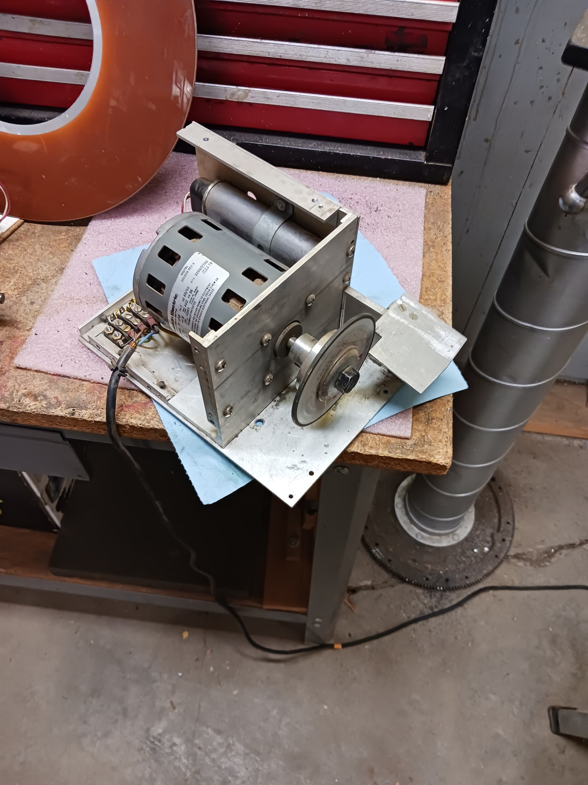

I have three hard disk drive motors, so I went out to the shop to get pictures. One motor is powering a carbide tooling sharpener. The other two are still waiting for a project.
The motors came from a DEC PDP? minicomputer which must have had three drives. The 10MB drives were made by Control Data, CDC, in Colorado. They made 10s of thousands of them. Every minicomputer had at least one.
The platter is from one of the drives. 5MB on each side. It is 14 inches in diameter. The platter assembly was belt driven from one of the motors.

Cap start/run?
No, all two phase with a fairly large phasing capacitor. Split-phase, as I recall the type.
Useful motors. Were you tempted to reverse the one with the grinding wheel so the tool rest could be on the other side?
No, I am ambidextrous.

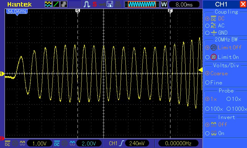

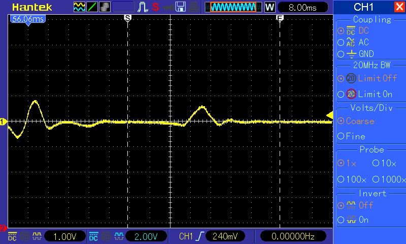

Going back to the original question, I don't have a BLDC motor to test but I just now I connected a scope probe to a NEMA17 400 step/rev motor that was sitting on my desk and recorded some waveforms while twiddling the shaft with my fingers.
The three pics are at different speeds, the middle one being much the slowest. Looks like there's lots of volts to play with but the waveform changes from isolated pulses at low speed to essentially sinusoidal at high. Might be a challenge to decode and one might get a dead zone for very slow twiddles.
