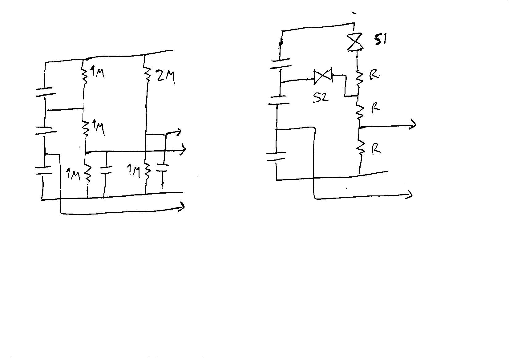

I'm a newbie with electronic hardware. I want to periodically measure each supercapacitor voltage in a series bank of three. The maximum supercapacitor voltage is 2.7, so the bank will not exceed 8.1 V. In fact, the voltage will be limited to 2.65 volts per cap. When I'm not measuring, I want minimum current draw. From some Google research, I surmised that the attached circuit might work. When I put D0 high on the Arduino, I want the MOSFETs to turn on the voltage divider circuits and take measurements of the three caps (from the A0, A1, and A2 input lines). When D0 is low, the voltage divider circuits should be off. Will this circuit work? Do I need any additional protection resistors or caps? Is the value of 100K for R5 and R8 ok? Thanks.
In the drawing I realize that I have the resistor values for R9 and R10 switched.
It looks like a well designed circuit.
But a couple voltage dividers, about 100k end to end, should not draw but about .2Ma. Is that to much. What is charging these caps, solar? What is their drain, without the voltage test circuit?

Consider the following. To measure the total voltage, use a simple voltage divider, 2M to +8.1V and 1M to ground. Also a 0.01uF capacitor in parallel with the 1M resistor to avoid crosstalk and noise pickup. Current draw 2.7uA.
To measure the voltage across the bottom 2 supercapacitors, use a voltage divider with 1M to +5.4V and 1M to ground, and the same 0.01uF capacitor. This draws 2.7uA from the lower 2 capacitors. To balance that, connect a 1M resistor in parallel with the top capacitor. See left-hand schematic below.
Total current draw is 5.4uA. If this is lower than the typical leakage current of the supercapacitors, then it is low enough to ignore. No need for any mosfets. The use of high value resistors in the voltage divider introduces a possible measurement error that is typically less then 1%. If you can tolerate a larger error, you can use higher value resistors.
Alternatively, you could use the right-hand schematic. S1 and S2 represent two switches in a 74HC4066 quad switch IC that is powered from the capacitor stack, or alternatively from a separate 9V to 10V supply. To measure the total voltage, close S1. To measure the voltage across the first 2 capacitors, close S1 and S2. You will need a level-shifting circuit to provide the 8.1V drive for the 74HC4066. Alternatively, if you use a 74HCT4066, you can probably drive it direct from the Arduino (you'll be operating it with Vcc outside its recommended operating conditions, but well within its maximum rating).
In the event that the capacitors become unbalanced due to different leakage currents so that one is in danger of exceeding its rated voltage when you recharge them, you could also use 74HC4066 switches to connect a resistor in parallel with the capacitor(s) concerned.

Thanks for all the replies. The caps are 310F Maxwell supercaps with a leakage current of 0.45 mA. I'm going to use a solar panel to charge these caps. The caps will power a small load when it's dark. For now, the Arduino is just a data collector and will be powered off a separate battery. I will have a balancing circuit attached to these caps as well which prevents any cell from going over 3.65 V (http://www.instructables.com/id/Lets-learn-about-Super-Capacitors-A-Practical-G/step7/Balancing-Your-Series-Banks/). I didn't realize I could use such large resistors in the voltage divider (i.e., ~ 1 M). I had read that the total resistance going into the analog port should be on the order of 20 K. I also will investigate the optoFET idea. It's not a big deal to make proto circuits for all these suggestions and see which one's work the best. I might even learn something. The MOSFETs I wanted to use are logic level MOSFETs (e.g, IRLML2502).

Higher values are OK to use, with some caveats:
  1. The input resistance of the ADC is quoted as 100Mohms typical. Therefore, you can expect that each 1M of source resistance will introduce about 1% error.
  2. The Arduino analogRead function allows very little time between switching the ADC to the requested analog input and starting the conversion. This means that there can be insufficient time for the sample capacitor to charge if you are using a high source resistance and read a different analog input last time, resulting in apparent crosstalk between the inputs. You can avoid this in software, or (if the voltages you are measuring change only slowly), in hardware - hence I suggested the 0.01uF capacitors.
  3. Using a high source resistance will mean that the pin is sensitive to noise pickup. This can be avoided by using careful layout and/or by adding the 0.01uF capacitor to ground.

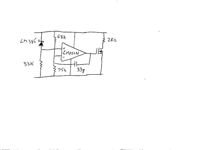

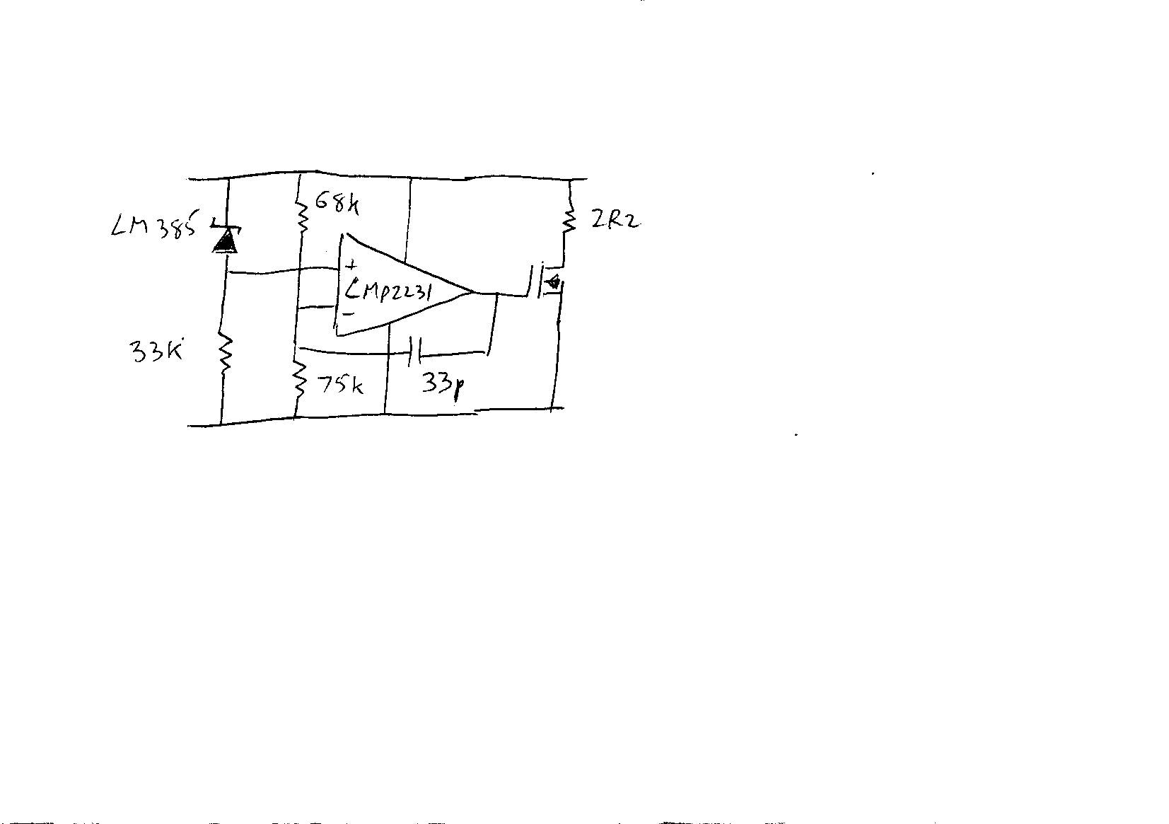

That's a nice balancing circuit, however I would modify it to use one less resistor and have better noise immunity - see attached.
The one issue with your circuit is that the p-channel MOSFETs will not turn on fully if the caps are at a low state of
charge since you rely on the capacitor voltage to provide Vgs for them. A CMOS analog switch is the better solution
but still relies on an adequate supply voltage to operate. But given the leakage current rates the simple option of
high-value resistors in the divider (plus capacitor) seems the simplest.
