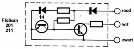

I found that some connect the white wire to a 5V computer unit with a pullup resistor to 5V (https://www.peter2000.co.uk/aviation/shadin/floscan_manual_nov07.pdf).
That is possible because of its open collector output.
In 1980, there is a electronics magazine in the Netherlands which shows the internals of the flow sensor.
afbeelding
It is on page 10-62 here: https://archive.org/details/Elektuur204198010/page/n43/mode/2up

The output is open collector, so you need a resistor between the white wire and the 5V of your Arduino (if your Arduino is operating at 5V and not 3.3V). That resistor is called a pull up resistor because it pulls the output up to the supply voltage when the transistor is turned off.
