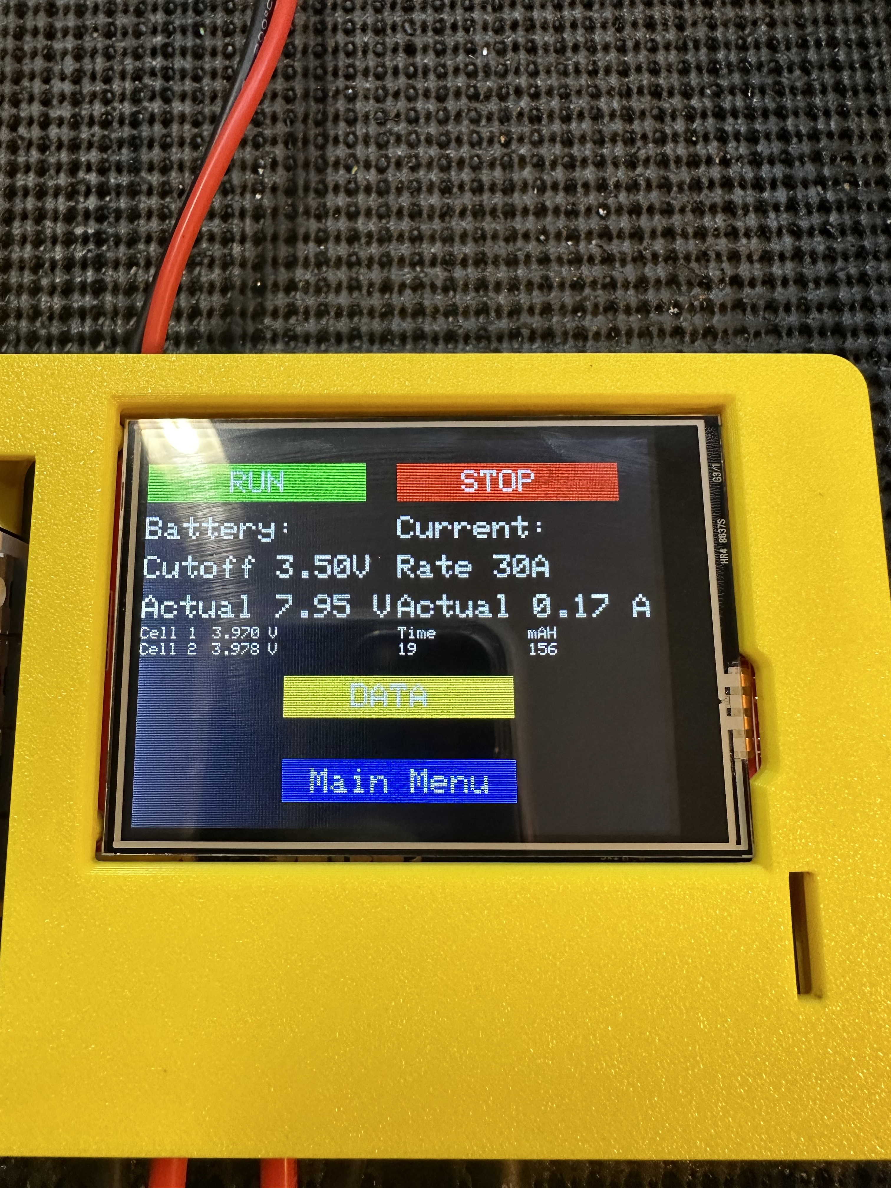

I've built an RC battery discharge for 1s and 2s Lipo batteries. It has been an extremely fun project, but there have been slight issues along the way.

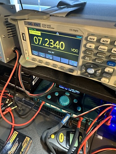

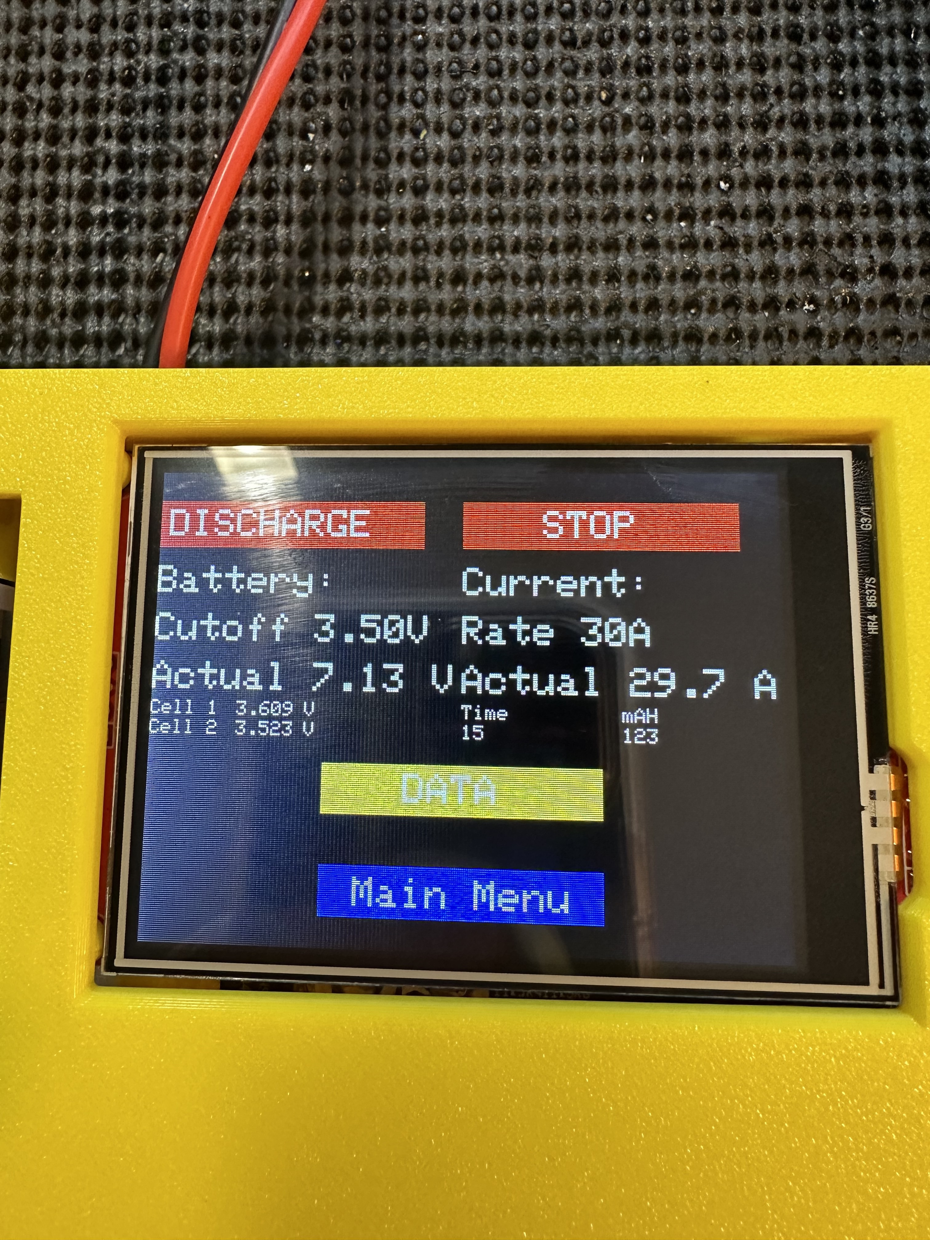

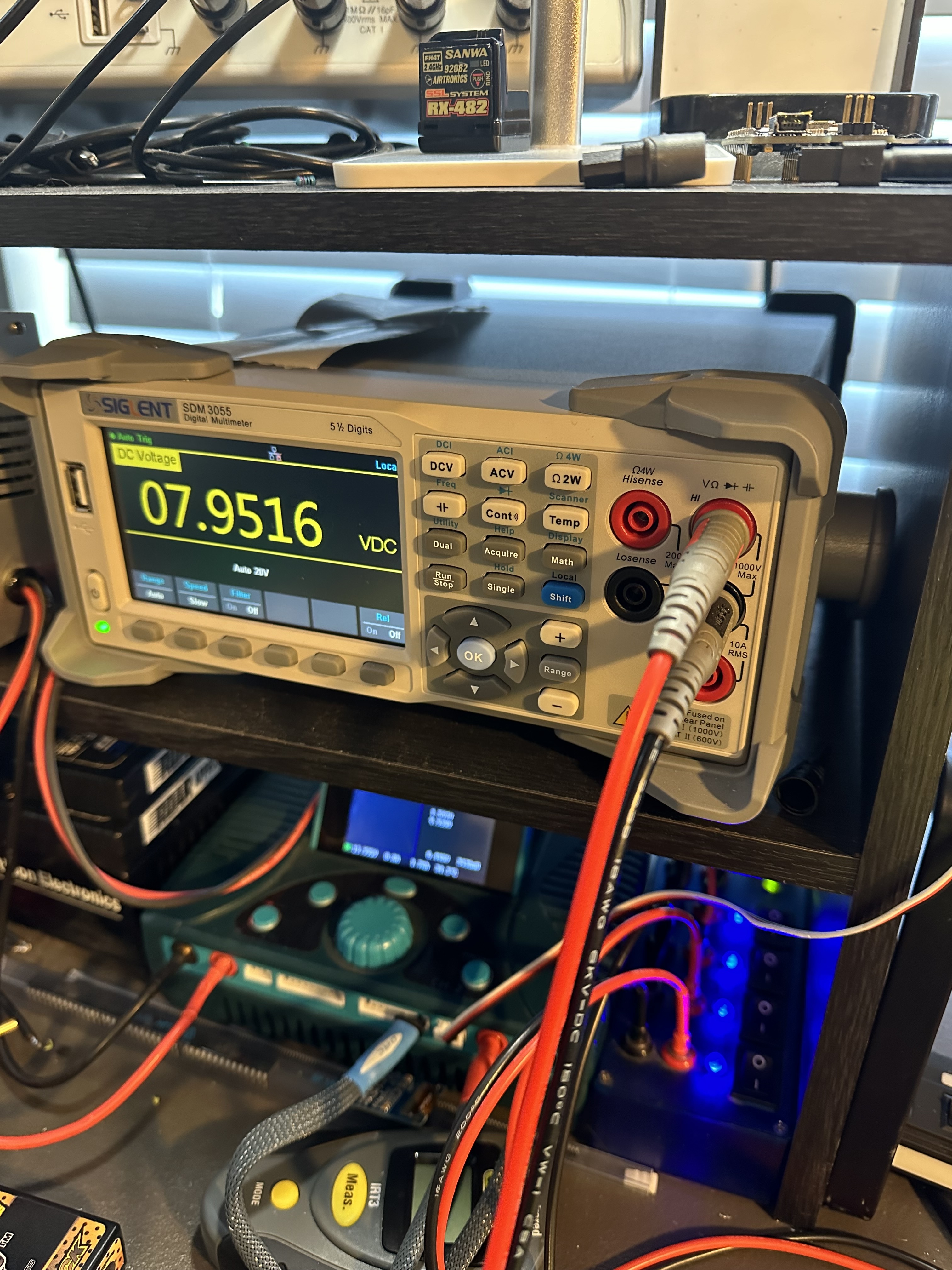

The current issue I am working on is the voltage under load. Reading the battery voltage with no load returns decently accurate results, but once I put a load on the battery, which is the idea, the reading is incorrect. How incorrect the reading is, depends on how big the load it. At 10A, the reading is off by about 0.04V. At 30A it is off by about 0.10V. Most of this seems to be in cell 2.

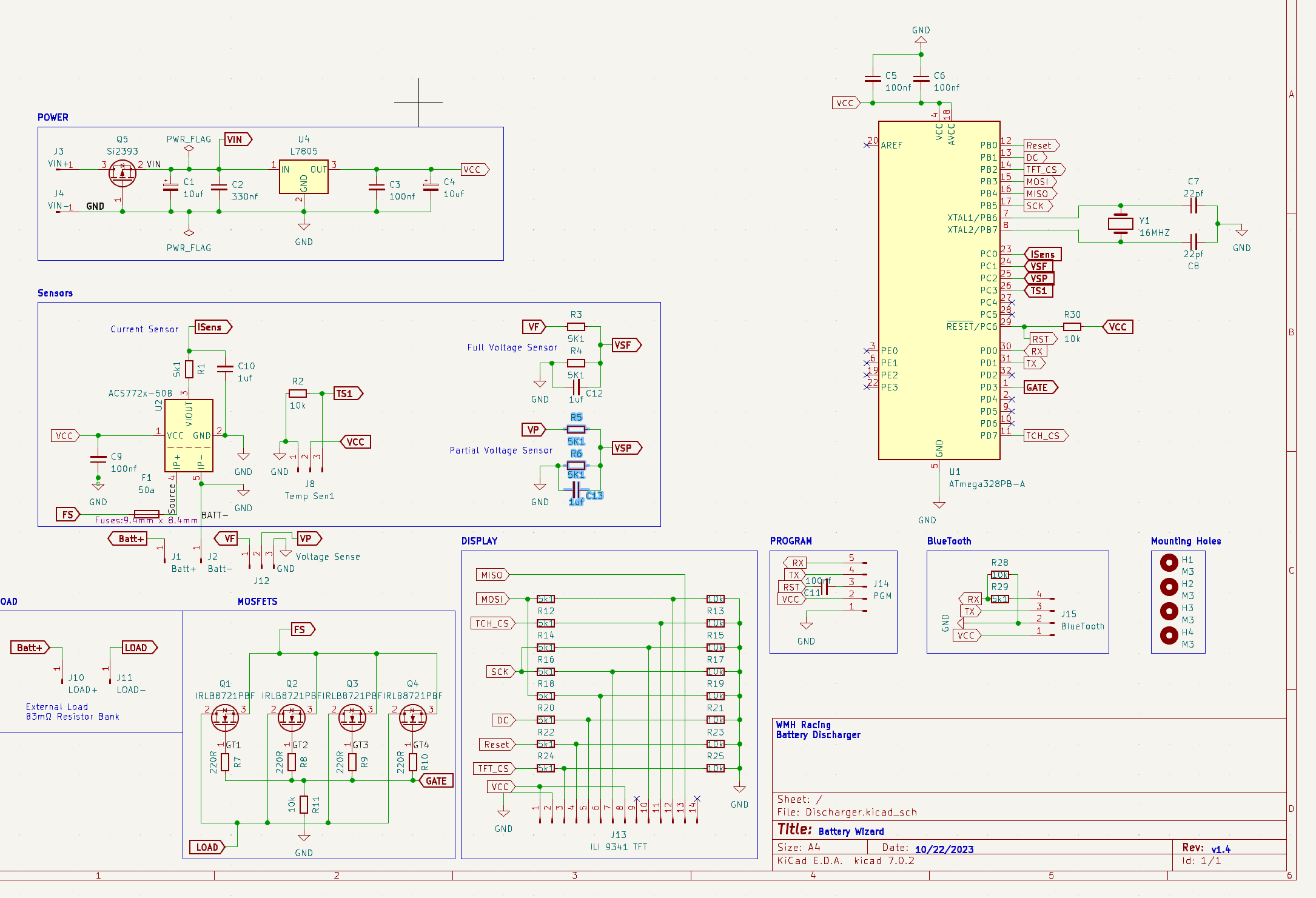

The voltage readings are done through a voltage divider of 2 5k1 resistors. I also added a filter cap of 1uF. The readings are averaged a lot, lol. But I have tried no average and high averages. I have tried to turn off the serial function, and have it on. I've tried without the filter cap.
In all honesty, I'm not sure if this is my code or hardware... But I'll put my code here, it is about 900 lines.

Seems you have proven that all batteries have internal resistance. The older and more used the battery is, the higher the internal resistance.
Well, yes that is another thing this unit measures. But that isn't the case here. Yes there is internal resistance, but look at the pics I put up in my second post. The under load voltage is off, not just lower like it should be. My unit gives the wrong voltage.
Are you using bare calls/batteries or do they have some type of management devices included?
Exactly. That is due to the battery and wiring internal resistance.
Ok on the first, I get the /1023 and /1024.
On the second, I have measure VCC under load and it is stable. The load doesn't interfere with the voltage regulator. Also, I am using the internal bandgap to calibrate VCC in the code, so if VCC changes then the calculations should change.
I am using a 4 wire method here. The wires that are connected to the battery for voltage are not the same paths used to deliver the load. So wire resistance shouldn't be an issue.
The problem isn't the voltage drop under load, the problem is it is measuring it incorrectly compared to my DMM. Which I'll trust my DMM over my code.

Please post a hand drawn schematic diagram of the entire test rig, so we have a clear idea what you are talking about.
No need for a hand drawn.
My routing could use work... But here is the layout.
That is part of the system schematic.
AREF requires a decoupling cap. Without it, you can expect excessive noise in the ADC readings.
Well that is one I have missed on all my designs then. Even when aref is VCC?
I think I may have come up with a code way to fix it. Like I said, this is only under load and it seems to be proportional to the load current.
So this is what I placed in my code and my dmm agrees with the results so far.
 if (isrunning==true){
  voltagePartial=((Pvoltage*(ValueR1P+ValueR2P))/ValueR2P)+((IV/1000)*4);
  voltageFull=((Fvoltage*(ValueR1F+ValueR2F))/ValueR2F)+((IV/1000)*4);
  cell1=voltageFull-voltagePartial;
  cell2=voltagePartial;
 voltagePartial=((Pvoltage*(ValueR1P+ValueR2P))/ValueR2P);
 voltageFull=((Fvoltage*(ValueR1F+ValueR2F))/ValueR2F);
