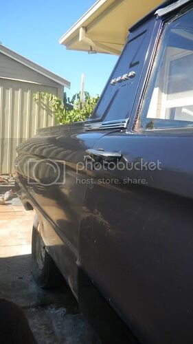

I've been restoring an 1964 Ford Falcon Ute, learning heaps as I've been doing, and trying to make it as high tech as possible. And my current plan is to have no physical controls, keys, air-con controls, light controls. I want to route it all through an android tablet.

And cause I can, here's the car I'm talking about: This is when I first got it (sort of) Two years worth of work:

Your questions depend on how the controls in your truck are supposed to work. In my '87, the controls are split between mechanical linkages, cable linkages, and vacuum switches/actuators. A relay board by itself wouldn't be able to control any of those. If all of your controls are electric switches, then a relay board is a good starting point. Getting a wiring diagram would also be useful. Some functions, like the ignition system, require multiple things to happen at once.

The wiring/engine is from a later model car, a 89 model, so all the switches for the controls are simple on/off buttons. With the only exception being the temperature control, the existing control pulls a wire that open and shuts a shutter to swap between cold & hot. But I was toying with the idea of using an acuator like an automatic locking acuator, and setting the time it's on and off. Unless somebody has a better idea?
The ignition, I was planning on using an RFID Alarm to control the locks, and put it into on position, then it's one wire crossed to have ignition, which the relay can handle (hopefully).
