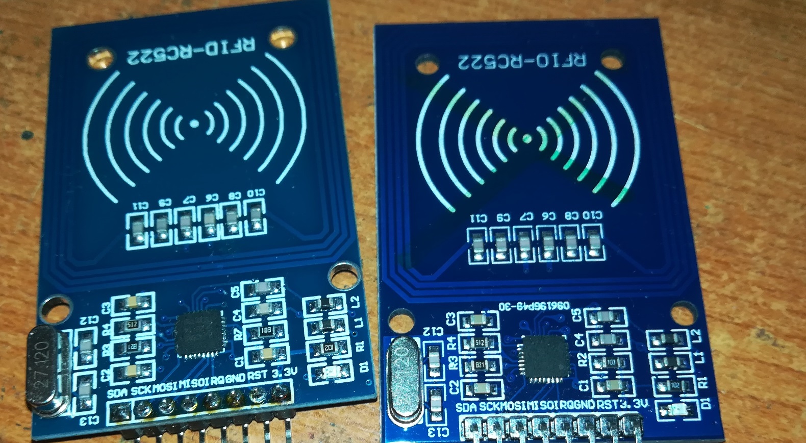

Attached is an image of my 2 boards. I'm pretty sure they are both SPI, please correct me if I am wrong. Maybe the manual is wrong, or even better, the seller doesn't even know what he is selling...
So the solution is to buy a new board and hope for the best?
Watch carefully the chip pins, I received one board with some solder between two pins so it didn't work. I removed it and now the board works.
The soldering looks rather bad on the pictures.
In any way, connecting that board directly to an UNO might fry it.
RST/Reset 9
SPI SS 10
SPI MOSI 11
SPI MISO 12
SPI SCK 13
On your picture none of the pins is labeled SS, so which pin did you use for SS?

Here it says "SPI SS SDA(SS) 10" so I just hooked up the pin labelled "SDA" to pin 10.

The MFRC522 is not 5V tolerant. The UNO has 5V on it's SPI pins but the MFRC522 must not get more than 3.6V (according to the datasheet). So you need a level converter.
Well, doesn't the module already have one? I mean, all the YouTube videos show these exact modules being used at 5V.

No, it has not.

No there isn't, see schematic here
Unfortunately there are many videos and projects that are only a show, they works only for few minutes just for the show.
I used that board for testing without level shifher for tha same reason, many schematics doesn't have one, but thanks to Whandall I checked that and discovered I was wrong.
Alternative to a level shifter is a 3.3V board.
