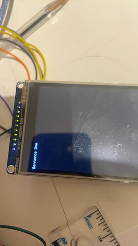

So it has a ST7789D display driver, so I use the AdafruitST77XX Library (Adafruit ST7735 and ST7789 Library). However, after modifying the example to simply display some text, something very strange happens
The text is faded, like its missing some pixels. However, when pressing the reset button on the arduino, or programming the board the text is displayed perfectly. Also, if i connect the RST wire to the arduino RESET pin instead of the Digital pin, this text becoming better effect disappears
I'm guessing this is a hardware issue, as there's no way the text can be displayed perfectly on the reset button press or programming, but not when program running
I have the idea of using a HX8347D library instead, but I cannot find a library that uses this screens pins (e.g MOSI)
I have the code and the pictures below, if you have any libraries or suggestions please let me know

Wiring: 5V - 5V, GND-GND, MOSI-D11, SCLK-D13, CS-D10, DC-D8, RST-D9, BL-3.3V
Hello @tf07.
Why do you think so? Your program prints "Sentence One ", waits 10 seconds, prints "Sentence Two ", waits 5 seconds then prints "Sentence One " again. I think this is the problem and it is software. Before you print text, you erase the entire display and this can take a few seconds and a lot depends on the microcontroller but you didn't say what Arduino you are using. Try making both delays 10 seconds or even longer.
Hi @flashko
Thanks for your input!
I'm using the uno, and I tried adding some more delay between printing sentence two and sentence one. also after "fillScreen" I added 10 sec delay.
Neither of these worked, and the text is still faded. I assumed this was a hardware issue because I couldn't see how my code was incorrect.
The only other thing I can assume is using a HX8347D library instead of the ST7789 adafruit library, but I can't find a library for it
