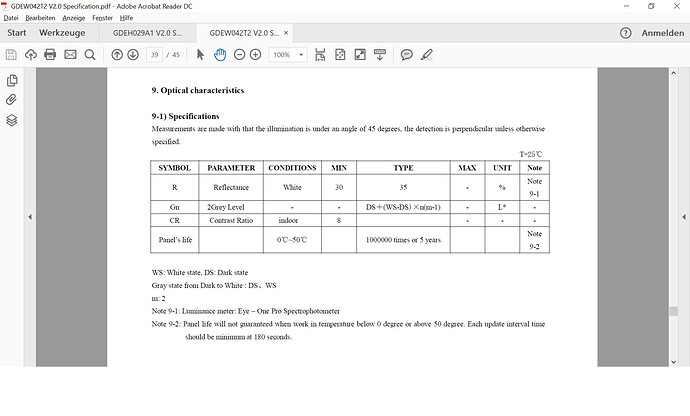

Have you ever seen typical Number of refresh specified on supplier datasheets ? (I haven't seen any)
@barsailer,
I did my longtime test with GxEPD/PartialUpdateTest.ino at master · ZinggJM/GxEPD · GitHub
On a 1.54" b/w panel GDEP015OC1.
After about 10 Mio refreshes it showed some persistent ghosting, as far as I remember.

Seems new releases of Panel specification doesn't specifies Panel lifes in Number of refresh anymore.
On your datasheet interesting to note the 1.000.000 Million refresh OR 5years with the refresh period of 180s.
1 million cycles with such period is 5.7 years I cannot imagine you started your long run of 10Millions cycles before e-paper technology is born :wink:
With your 1s period on your long life test and 10Mc before ghost image, my application profile looks not so much at risk.

Be careful with your remarks, if you want further responses. The example uses refresh every second on the 1.5" display.
Very clear to me
Very clear to me you spent 4 monthes testing and not 57 years :wink:

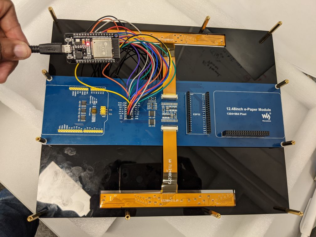

HI ZinggJM,

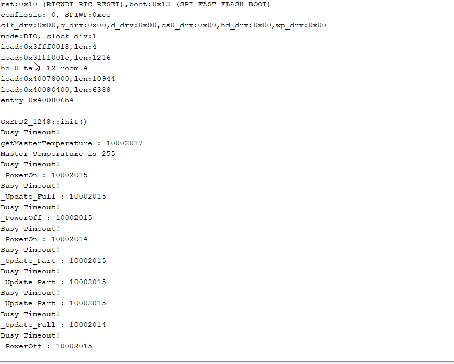

I am new to this topic and i have waveshare 2.9, 4.2 , 12.48 inch e-paper b&w display i am trying to connect the e-paper display with ESP32 dev module when i try to run the example code.
I was able to compile and run the code for 2.9 and 4.2 inch display. but when i try to the run the same code for 12.48 inch display i could not achieve anything on the screen.
i followed the connection provided in the example for 12.48 and also tried to change the pin according the HW SPI present as show below
GxEPD2_BW < GxEPD2_1248, GxEPD2_1248::HEIGHT / 4 >
display(GxEPD2_1248(/sck=/ 18, /miso=/ 12, /mosi=/ 23, /cs_m1=/ 5, /cs_s1=/ 22, /cs_m2=/ 33, /cs_s2=/ 19,dc1=/ 17, /dc2=/ 25, /rst1=/ 16, /rst2=/ 14, /busy_m1=/ 4, /busy_s1=/ 26, /busy_m2=/ 13, /busy_s2=/ 32));
The E-paper displazy is
i also tried the example to run with Arduino uno but nothing has helped to power up the e paper dispaly.
Could you please guide me towards correct direction in getting the display work.
i will attach the following output and connection i have achieved in the post.
Thanks for understanding
With Regards
Lakshminarayana K S
Hi Lakshminarayana K S, welcome to the forum!
Yes, I can try. But I am always short on time, so I give you a quick answer, and will maybe answer further questions in more detail.
I think the connector you connected your processor to is on the 5V side of level converters.
This may be the reason for not working with your ESP32.
I used a Waveshare ESP32 driver board, mounted on the connector intended for this.
I recently compared the driver board to a no-name ESP32 devkit board with the same number of pins, and was pleased that it has the same pinout. So I might spare one of my driver boards. But I didn't try it on this 12.48" board yet.
I suggest that you compare your ESP32 board pinout to the driver board also, and use jumper wires to the ESP32 socket, if it doesn't match directly.
Added: my processor board is a devkit V2, I think, and it has a VIN pin connected to the 5V from USB.
And I think you need a quite strong 5V power supply to the board. I don't remember if the USB connector of the driver board was good enough, but I think so.
Jean-Marc

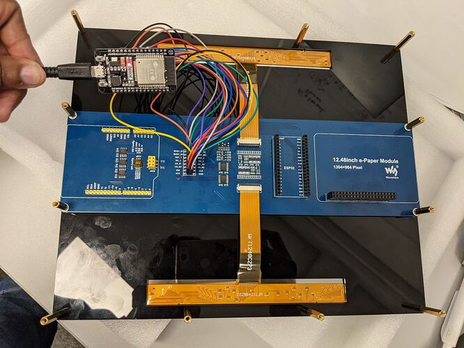

Hi ZinggJM,
I tired the things you mentioned above, when i provided 5V supply to Vin pin of E-paper i got the similar Output has previous mentioned above.
Their was no luck with other setup also.
Hope you have solution for this.
I am attaching the output for reference.
Yes, the solution is simple: buy a Universal e-Paper Raw Panel Driver Board, ESP32 WiFi / Bluetooth Wireless board.
It matches to the connector on the board on the backside of your panel.
And it also works directly with my library, I just checked again.
You would need this and check with the Waveshare demo code, if you want to prove if your panel is defective.
You could also buy a ESP32 devkit V2 or clone, with the same pinout, to check. These are less expensive. I also checked that it works right now.
Note that I needed to compile for WEMOS LOLIN32, because when I compile for ESP32 Dev Module the program hangs (Serial.begin() issue).
You did not provide a list with your wiring connections (point to point), so I can't check against your constructor parameters.
But you use an input only pin for cs_m2, and the standard MISO pin for cs_s2.
I will not spend time on reproducing and checking your wiring.
For your test with Arduino UNO you may need to close the ICSP switches. These are strangely placed, as far as I remember. Check the schematics. Note that UNO will be very slow with this display, because of heavy paging.

Hello ZinggJM,
i was able to get it work with the esp32 node32s device but no help with esp32 dev module.
Thanks
