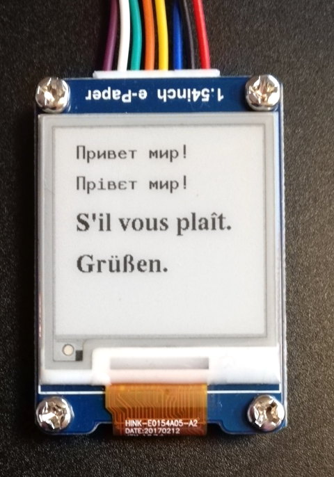

Dear ZinggJM,
Could you, please, advise if there is a way to make the Cyrillic text a bit bigger. The following code works fine except that the text in Cyrillic font is small.
I could not find a bigger Cyrillic font in the U8g2 fonts. And I could not figure out how to add a custom font. There is no such issue with the French and German fonts as you can see on the photo.
I like this Cyrillic font, it works both for Russian and Ukrainian languages. If only there was a way to scale it a bit bigger.
[SOLVED] See: Cyrillic fonts for U8g2_for_Adafruit_GFX (on 1.54 inch E-Ink display) - Displays - Arduino Forum
// mapping suggestion for AVR, UNO, NANO etc.
// BUSY -> 7, RST -> 9, DC -> 8, CS-> 10, CLK -> 13, DIN -> 11
// base class GxEPD2_GFX can be used to pass references or pointers to the display instance as parameter, uses ~1.2k more code
// enable or disable GxEPD2_GFX base class
#define ENABLE_GxEPD2_GFX 0
#include <GxEPD2_BW.h>
#include <GxEPD2_3C.h>
#include <Fonts/FreeMonoBold9pt7b.h>
#include <U8g2_for_Adafruit_GFX.h>
#define MAX_DISPAY_BUFFER_SIZE 800 //
#define MAX_HEIGHT(EPD) (EPD::HEIGHT <= MAX_DISPAY_BUFFER_SIZE / (EPD::WIDTH / 8) ? EPD::HEIGHT : MAX_DISPAY_BUFFER_SIZE / (EPD::WIDTH / 8))
// select one and adapt to your mapping
GxEPD2_BW<GxEPD2_154, MAX_HEIGHT(GxEPD2_154)> display(GxEPD2_154(/*CS=10*/ SS, /*DC=*/ 8, /*RST=*/ 9, /*BUSY=*/ 7));
#include "GxEPD2_boards_added.h"
U8G2_FOR_ADAFRUIT_GFX u8g2Fonts;
  Serial.println();
  Serial.println("setup");
  display.init();
  u8g2Fonts.begin(display); // connect u8g2 procedures to Adafruit GFX
  helloWorld();
void helloWorld()
  //Serial.println("helloWorld");
  uint16_t bg = GxEPD_WHITE;
  uint16_t fg = GxEPD_BLACK;
  u8g2Fonts.setFontMode(1);                 // use u8g2 transparent mode (this is default)
  u8g2Fonts.setFontDirection(0);            // left to right (this is default)
  u8g2Fonts.setForegroundColor(fg);         // apply Adafruit GFX color
  u8g2Fonts.setBackgroundColor(bg);         // apply Adafruit GFX color
  display.firstPage();
  do
    display.fillScreen(bg);
    u8g2Fonts.setFont(u8g2_font_10x20_t_cyrillic);  // select u8g2 font from here: https://github.com/olikraus/u8g2/wiki/fntlistall
    u8g2Fonts.setCursor(20, 30); // start writing at this position
    u8g2Fonts.print("Привет мир!");
    u8g2Fonts.setCursor(20, 60); // start writing at this positionu8g2Fonts.setCursor(20, 30); // start writing at this position
    u8g2Fonts.print("Прівєт мир!");
    u8g2Fonts.setFont(u8g2_font_timB18_tf);  // select u8g2 font from here: https://github.com/olikraus/u8g2/wiki/fntlistall
    u8g2Fonts.setCursor(20, 100); // start writing at this position
    u8g2Fonts.print("S'il vous plaît.");
    u8g2Fonts.setCursor(20, 140); // start writing at this position
    u8g2Fonts.print("Grüßen.");
  while (display.nextPage());
U8g2_for_Adafruit_GFX doesn't seem to have a setFontSize() method, but even this would not help, as you are looking for "a bit", not a multiple.
I tried the obvious, searching for "Cyrillic" in the forum, but didn't find something obvious.
I suggest you create a new topic, e.g. "Cyrillic fonts for Adafruit_GFX or U8g2_for_Adafruit_GFX", as this is of general interest. Don't just copy the text of your post (cross-posting is disliked), but add a link to your post. I am sure the experts will have an answer, or hints where to look.
Jean-Marc
Added:
Found available Fonts to use with Adafruit_GFX
see also: Adafruit_GFX fork extended for UTF-8 by Bodmer.
