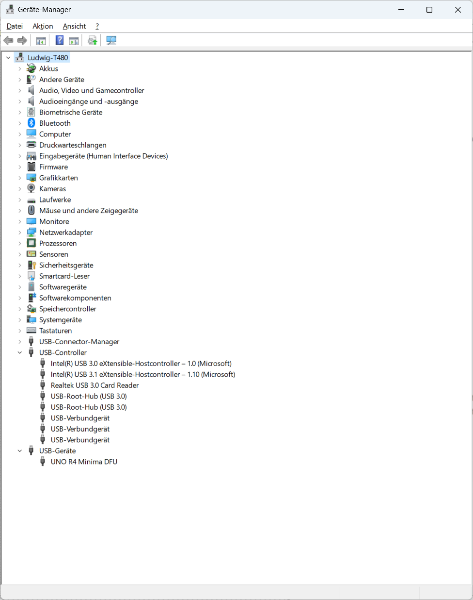

Somehow I managed to flash the Arduino Uno R4-minima bootloader in the first board.
Then I tried it with the second board. But for some unlucky reason flashing the minima-bootloader did not work.
If I look up the successful flashed board the devicemanager show this
There is an entry
and
In the Arduino-IDE 1.8.19 it shows up as
If I connect the unsuccessful board it shows this
but no COM-Port entry
If I hold down the MD-button (boot) and then press and release reset the device manager shows

I just tried another time to upload a sketch and it was .....
successful !!
Now the board shows up as
and sketch is running !
So it seems to be nescessary to do a first uploading a sketch to get the Uno Minima entry
in the arduino-IDE and the
entry in the device manager.
Now I have managed to flash the bootloader but I am unsure what were the steps that made it happen.
