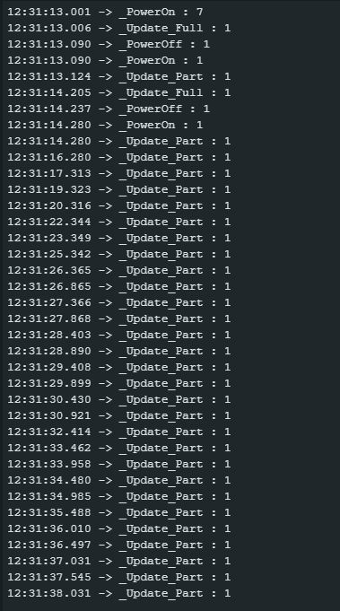

Since I'm a newbie I've found very confusing the example reported and I was not able to adapt it to my needs : however, if I've interpreted the code in the correct way, the code contains two different functions, one for BW display that allows for partial refresh and the other for the 3color display that doen't have this chracteristic. This is not a big issue since I'm planning to do only complete refresh of the screen every 15 minutes.
When I run the code of the example nothing happens on the screen but in the serial monitor that is a long list of Update_part:1 that stops only when i disconnect the MCU
I suppose that the first three lines show a full refresh, the following four lines a full and partial refresh, then after a new PowerOn there is an endless list of Update_Part: 1 .
In conclusion, while I was able to "decode" the different examples with OLED or TFT displays so that I was able to adapt them for my needs with this display I' am just in a dead stop.
Could a good Samaritan help me by explaining in simple words how to refresh this blocked screen and display just text messages ?
Thanks in advance for your help.

Your wiring differs from the comment in the example!
report the inking found on the flexible connector of the e-paper panel.

For the wiring I followed what is written in the example CS = 5, DC=0; RST = 2 BUSY = 15 but I realize that I made a mistake connecting SCL to 21 and SDA to 22 as for an I2C connection when this display works through SPI. I was confused by the fact that they call these pins SCL and SDA instead of MOSI and MISO even if in the back of the panel it's clearly written 4-lines SPI.
So your remark that my wiring was wrong is quite right and I was able to realize my mistake thanks to your observation.
To your second question I have no flexible connector on the e-paper panel but I post a picture of the back of the display where there are the connections, hoping this could help.
However, with wiring SDA to 23 and SCL to 18 now I succeeded in refreshing the screen and running the code.
Really a big thx for your help.

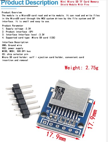

Hi ZinggJM
I'm writing again because, after having successfully displayed the data collected from temp and hum sennsor together with time stamp on the eink display I met another problem that I was not able to solve even after many trials.
The problem is: how can I connect a SD card module to my ESP32 while the eink display is connected with SDA to 23, SCL to 18, CS to 5, D/C to 0, RES to 2, BUSY to 15 ?
I tried to define CS, SCK, MOSI and MISO for the SD card as 33, 25, 26, 32 but I encountered in one case a "Stack smashing protect failure" with continuous rebooting and after some changes in the cose now simply the message "Card Mount failed".
In any case I was not able to make the SD card work.
I know that ESP32 has a VSPI and a HSPI with GPIO 13 GPIO 12 GPIO 14 GPIO 15 for HSPI and GPIO 23 GPIO 19 GPIO 18 GPIO 5 for VSPI ( MOSI MISO SCLK CS) but the eink is already connected to pin 5 for CS and to pin 15 for BUSY. so I was forced to define "custom SPI pins" that however in my hands do not work.
If you can help me I'd be very grateful.
Thx for your patience and attention but as a newbie as I am I'm completely lost.

Did you try to connect both to the same SPI bus? Just using a different pin for SD CS?
Did you see GxEPD2_SD_Example?

However, the SD card module that works without any problema when my OLED display is connected through I2C is this one ( the link of AliExpress seems not working so I'm enclosing a picture of the page where the item is advertised).
I thought that there was an easy way of using both the Epaper display and a SD card module through SPI but it seems that this particular display with the wiring suggested (requested ?) by the seller is not compatible with a SD card module.

Here enclosed you'll find a pinout scheme because again the link to aliexpress seems not working.
