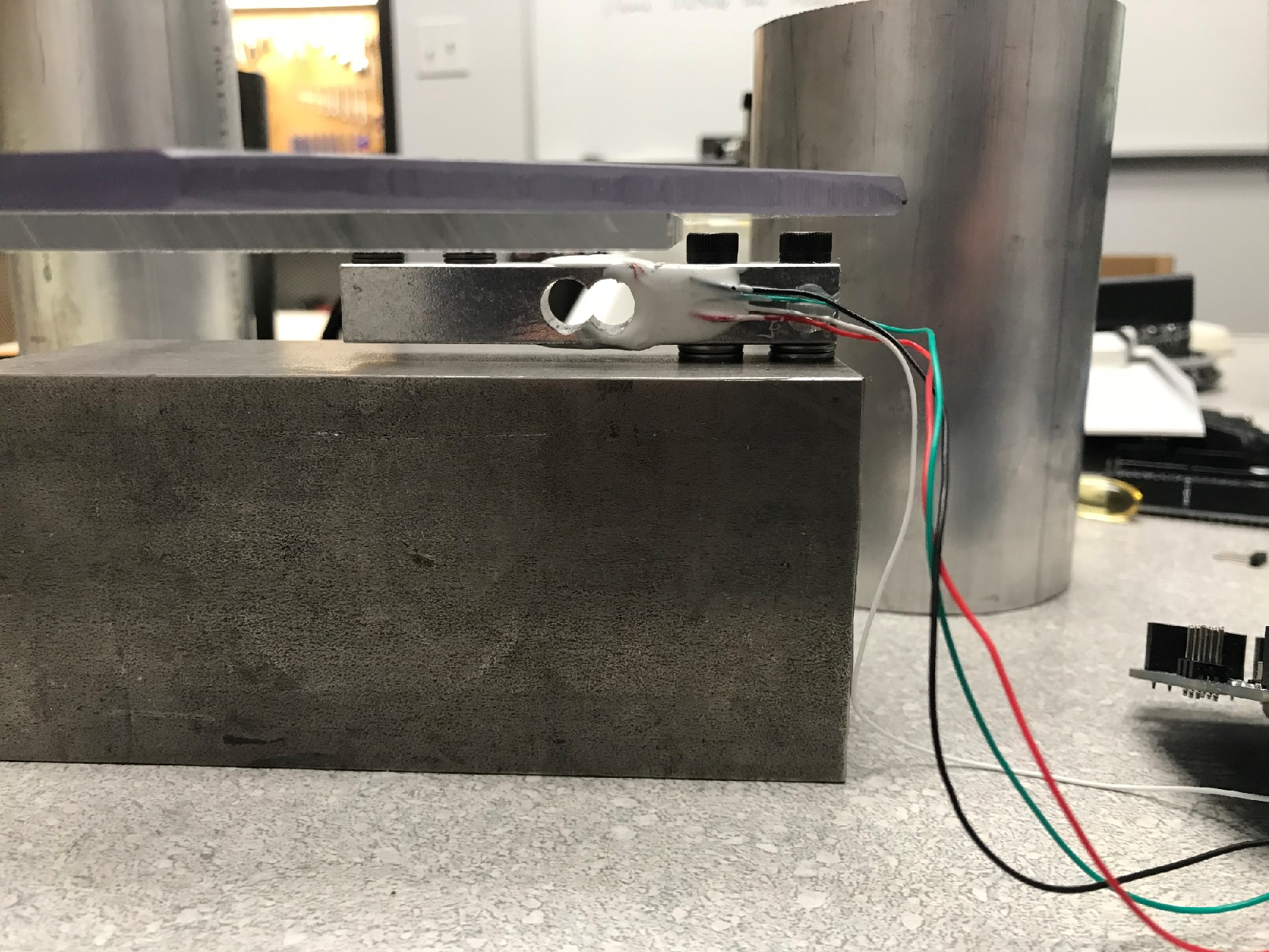

Regarding the no change in output when weight is added: a few clear close-up photos of your setup may reveal something.
(Oops - just noticed your photo. Please take a side view, too.)
Also, if I were you, I'd be curious about resistance between each leg of the load cell (when not under load and not attached to the HX711) and the voltages at E+, E-, A+, and A- relative to ground, under no load and under full load (after reattaching the cell to the HX711). Also, I'd be curious about the load cell's sensitivity (usually expressed in mV/V) to see if its output under full load matches the spec.
(Oops - just noticed your post about connecting red to +5...it should go to E+, not +5v, and black should go to E-, not ground. Also, this may be one of those boards where you need to connect E- to ground... see this topic. You will know that is the case if E- has a voltage greater than zero.)
And yes, of course changing to B+ and B- will change things. Read the datasheet.
So we can see it:
That is some serious base! :grinning:
Good picture; yes, I too would like to see a side view!
Here is a side view. E- and E+ on the HX711 is what I meant by gnd and +5v. Sorry for the confusion. I will check with the DMM and see what voltage I'm getting on E- and +, is that where I should check to see if the gnd is good on the HX711? I'll read that other linked post next, if its stated in there, disregard. I ordered another HX711 and another load cell on Friday, maybe between the two I can do one correctly. As for the 'beefy' base, I wanted to make sure my test bed was stable haha. A 5kg chunk of stainless steel may be a bit overkill in the actual application where it is going to end up... but for now, it is what it is.
