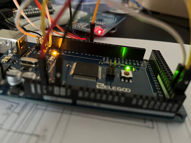

Hi! I'm a beginner in the world of Arduino and have recently started to create some projects.
I recently purchased an RFID scanner kit along with some tags and cards. I have used this RFID before and it has worked completely fine with an Arduino Uno.
In my latest project, I want to connect the same RFID scanner to an Arduino Mega. However, I always get the same error every time I upload the DumpInfo code: Firmware Version: 0x18 = (unknown).
When I connect the same RFID scanner to an Arduino Nano, I get the same error. However, the Arduino Nano is capable of reading the cards and tags and even outputs this information to the Serial monitor. The arduino mega does not read anything. I thought this behaviour was weird (yes, I did change the values of the constants in DumpInfo for both the boards). Is this some programming fault or is it some issue with the Mega?

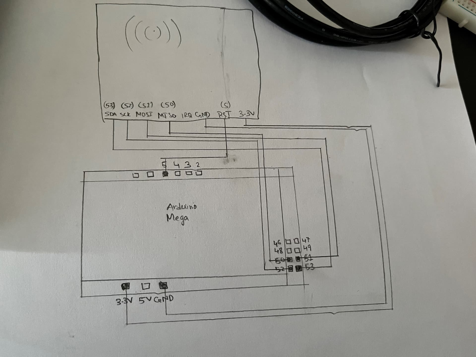

Please post a wiring diagram.
Also links to the scanner.
RST: 5
SS: 53
MOSI: 51
MISO: 50
SCK: 52
3.3: 3.3V
GND: GND

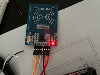

the RFID im using is RFID-RC522
We don't have the luxury of time to spend Googling stuff. You please. I said, "links" twice...

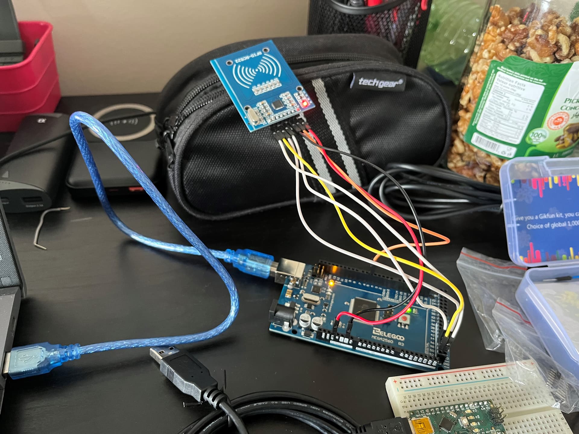

is this what you were looking for.
if Im doing something wrong, please tell me. This is my first time inside a forum
images
Did you follow the link in reply #4? Please read all that, and then post your code accordingly.
Definitely not, it's an anonymous small photo that only requires me to do research that I don't have time for.

I think, under these circumstances, you should break out a pen and paper, and show us a diagram with all your connections. Pin lists are only sufficient for projects that are working. Unfortunately, the photo doesn't show the connections clearly enough to verify them visually.
I tried the troubleshooting steps. The soldering is fine, the 3.3V is being powered correctly, the connections are all correct etc. If the RFID scanner is not working properly, then I don't understand how it is scanning teh cards properly when I rewire it and control it through an Arduino Nano.
Replace or rewire the jumpers. You might have a loose connection.
Still doesn't work. The same wires work with the Nano but not with the Mega. Is it an issue with a digital pin?

Sorry, still can't see the front of the RFID board (isn't that the labelled side?). Back off so things are in focus.
It is on the board schematic or you can measure from the pin to Vcc with a DMM.
There are no I2C pull up resistors on my board (the schematics I have looked at online show none).
rfid_front
This is the front of the RFID as you were requesting
