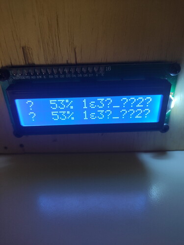

weird symbols appear on my LCD screen
i created an incubator so my arduino has to stay on for 20 days, however after a few minutes that my lcd screen is showing some data normally it starts showing up random numers, letters and symbols.
if you need the code i will post it.

the error is every time a bit different and it happens at a random time.
i'll add the tinkercad circuit with just the screen attached, the actual lcd screen model is 1602.
thanks for the help.

It appears as if the nonsense only appears on the part of the display where you are attempting to print the values. One possibility is that the sensor is not reading correctly and generating "nan" values - not actual numbers.
I do know that "String"s - those defined with the capital "S" cause program crashes in microcontroller code, but I'm not sure about the "String" functions. Someone else may pass judgement on this. :roll_eyes:
The "String functions" are actually String constructors, used for conversion. This forces the compiler to also convert the string literals to Strings, and to add Strings.
I would expect current compilers to not cause memory leaks with Strings. But you never know.
I would avoid this on low RAM microprocessors, such as AVR Arduinos.

so is it a memory leak due to the low amount of RAM? in this case i can't do anything to fix it, can i?
the "error" often appears in the zone where i am trying to write the time maybe it's an error of that part of code even if i have no clue of what it could be.
should i try to write the values individually to cause less stress to the RAM?
Yes, it is easier to avoid trouble, than to analyze and investigate where the trouble comes from.
There are many potential causes, missing destructor calls, missing destructor calls for auto-generated class instances, heap release management code...
I use the String class only with "grown up" processors such as ESP32, ESP8266, STM32...
Any network capable processor needs a heap management that works.

i noticed that not only the lcd screen stops working but also the serial monitor, when i close and reopen the serial monitor the arduino resets and it works for a bit.
more and more questions. (i deleted all the strings functions)
i have attached to the arduino a dht11, a servomotor, a relay module and the lcd screen... i tried to unplug individually every component and the error shows up only when the relay module is attached, if i unplug it the lcd screen works.
could it be an "energy supply" problem?

Well, that looks fairly straightforward. Powering it via USB, operating the servomotor for any significant duration may cause the "polyswitch" on the UNO to shut down, but the problem seems to be more related to impulses generated by the relay.
A 1 mF (one millifarad or 1000 microfarad) capacitor across the 5 V and ground on the relay module itself or a 220 µF capacitor across pins 1 and 2 on the LCD (or both!) would be worth trying. :grinning:
Beyond that, it would require alternate power supply arrangements - a regulated 5 V power supply of some sort (such as a USB "phone charger" rated at 2.1 A) with certain wiring arrangements.
It is most important that the mains wiring to the relay is bundled together so it forms no open loops and is kept away from all other wiring and all wiring is bundled together as it runs from one part to another, keeping 5 V, ground and signal wires as a bundle.
Right now i don't have any capacitor but i've found a power supply that is perfect.
I've wired the "+" with the 5v of the relay module and the servomotor(it was a bit "laggy" and now with the power supply it is smooth), and the "-" with the ground of arduino.
it is working fine but the error is still there (maybe it is less frequent).
do you think some capacitors could actually solve the problem?
It was the same problem with me. I was using the LCD without a petentiometer and I used a temperature sensor with it. It showed weird symbols. But, when the sensor was removed, everything worked fine ( no weird characters ). So my suggestion would be to remove everything and just keep the LCD connected to the arduino.
unfortunately for my project i need the lcd screen and a sensor for humidity and temperature, i ordered a DTH22 a few weeks ago but it is still on shipment, it is a more precise sensor but i don't know if it will solve this problem.
a 100 uF capacitor on the first two pins of the screen didn't solve the problem, i'll try with a bigger one
