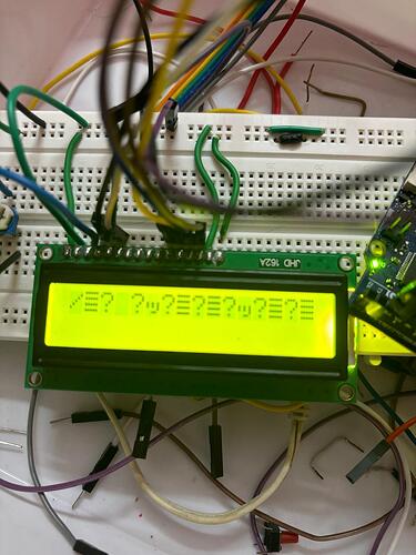

Lcd showing weird symbols

this is my code my lcd is not working for this i adjusted potentiometer and it doesn't work kindly help
this is the wiring i follow
That code will never end because you never update the variable "buttonPin" inside the loop.
As to your display you probably wired it up wrong. Just write a sketch that writes to the display and nothing else.
Always test the display with one of the sketches provided with the library.
Does it work with a Library Sketch? If not - post the adopted library sketch.
Please post a picture of your wiring/breadboard/LCD/Arduino so we can follow EACH SINGLE WIRE.
On your picture we can't see what pins you have connected to your LCD. Especially what you have done with the RW Pin of the LCD.
Have a look at that again, the code is reading the state of the pin, not comparing the value of the pin number.

Try your sketch with the servo disconnected. Motors can cause interference which can corrupt the signals going between the Arduino and the display.
it works for a very short time and it goes back to this when i used the blink sketch from liquidcrystal
everything except the display works fine
hey it kinda works for like 2 sec but it's back to those symbols , and i also should use the servo as it's important , kindly suggest a way
So the fault is intermittent but occurs even when the servo is not attached?

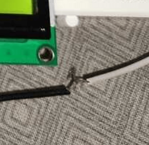

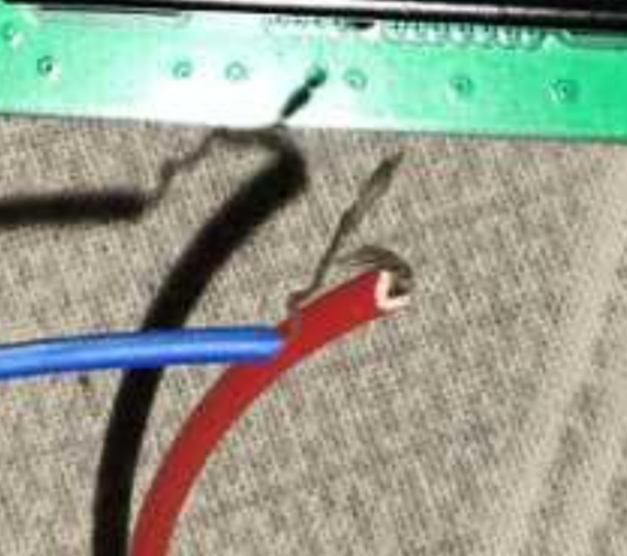

You need to do better with your wiring. Twisting wires together isn't going to be reliable:
because they fall apart like this:
