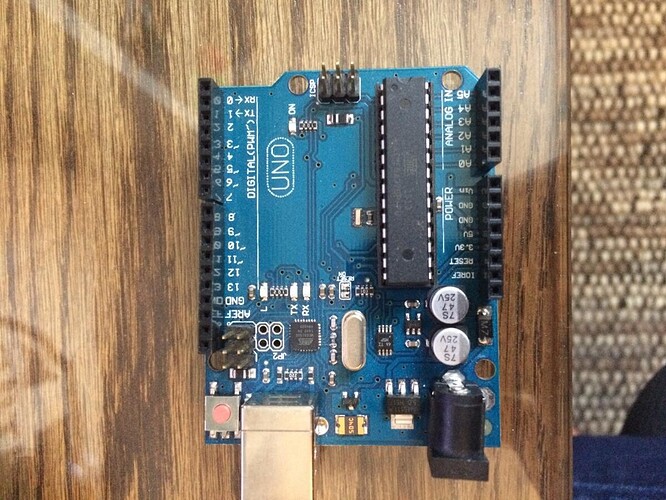

I have been trying to upload this code to my arduino for around a week now and I just cannot manage to get it to upload. I have tried 4 different computers and none of them can upload. I finally got COM1 to show up on my desktop but from there nothing. Here is the error code I get

Which Arduino board is it ? Is it an official Arduino board or a fake/clone/counterfeit ? Can you make a photo of it ?
Did you try different USB cables ?
When you try to connect to the Arduino board, remove everything from the Arduino board. Remove every sensor and all wires.
Have you installed the Arduino drivers ? When you install the Arduino IDE, then also the drivers are installed. When you unpack the Arduino IDE in a folder, you better install the newest drivers from the "drivers" folder.
Do you have a cheap clone with the CH340G chipset ? That is not an official Arduino usb-serial chip, and you have to install the drivers from : CH341SER.EXE - 南京沁恒微电子股份有限公司
If you have a clone board with the CH340G, how much did you pay for it ? They should cost no more than 3 dollars (http://www.aliexpress.com/item/Free-shipping-high-quality-UNO-R3-MEGA328P-CH340G-for-Arduino-Compatible-NO-USB-CABLE/1967735193.html).

Both of my boards are from either this website or the verified Amazon Arduino retailer. I have tried many different ports but only COM1 shows in the tool bar. I installed the arduino software but nothing else. If someone could explain what a IDE is to me I would be grateful. This is my first time with any of this stuff...

A verified Amazon Arduino seller doesn't mean a thing. Can you make a photo of your board ?
It does look very good, however, there are Arduino fake/clone/counterfeit boards that look that good. If it was shipped in a small Arduino cardbox box, then it is the real one. If it was only wrapped in plastic, then it is probably counterfeit.
The bootloader could be corrupted or the code in the usb-serial chip could be corrupted. Those things happen sometimes. Or it is just broken :frowning:
One way or the other, you have bad luck with this board.
Maybe someday you have a programmer or know how to use an Arduino Uno as programmer to burn the bootloader.
My best suggestion is to buy another Arduino board.

Ok! I have finally tried this test and everything worked as it was supposed to on both of my Arduino Unos. I think I have located the source of the error. I will do my best to explain. So the robot I was trying to make had a motor shield and 4 wires going into it. The wires were attached to a breadboard which led into a HC-SR04 sensor. Wires went from the sensor to the 12, 13, GND and 5V slots. I am able to upload data to my board when it is plain with nothing on it. I am able to upload to my board when the motor shield, power and motors are attached. But, as soon as I plug in the wires from the sensor to the Arduino it no longer shows up as an upload port. I think the drivers I have installed are good because when I plug my Arduino in it shows up as COM4 and says Arduino Uno next to it in both the device manager and tool bar of IDE. It is vital to my robot that these wires connect from the sensor to the arduino so I am really at a loss about what to do. One of my motors crapped out on me so I wont be able to do much real testing with motors until Thursday. I have a large pack of wires consisting of female to female, male to male and male to female. I am assuming that my error is in the way I have set those up. Here is a visual representation of the wiring. http://cdn.instructables.com/F09/ZP5N/I5S2F3V3/F09ZP5NI5S2F3V3.LARGE.jpg
