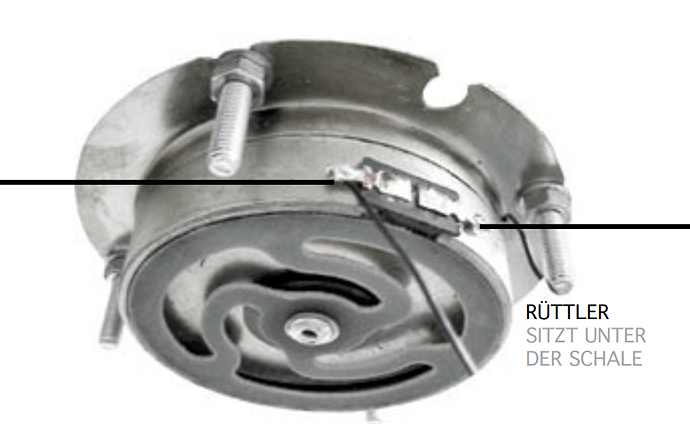

what is the name of this component?
I want to use it to make water wavy.

Possibly some form of high frequency loud speaker (tweeter), but I am not saying that with any confidence. What do you think it is? Where is it?
Looks like an annunciator or horn etc.
Google says it's a "jogger".
Paul

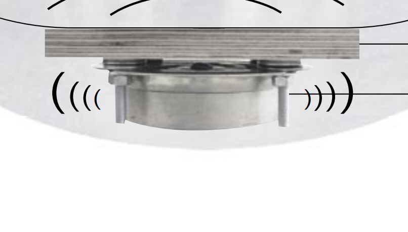

Surface transducer.
It's a reverse loudspeaker.
The voice coil is attached to a weight while the relatively light magnet is mounted to a panel. The recoil from moving the weight shakes the panel to which it is bolted, and the panel radiates the sound - or vibration.
"jogger" is a fair description.
