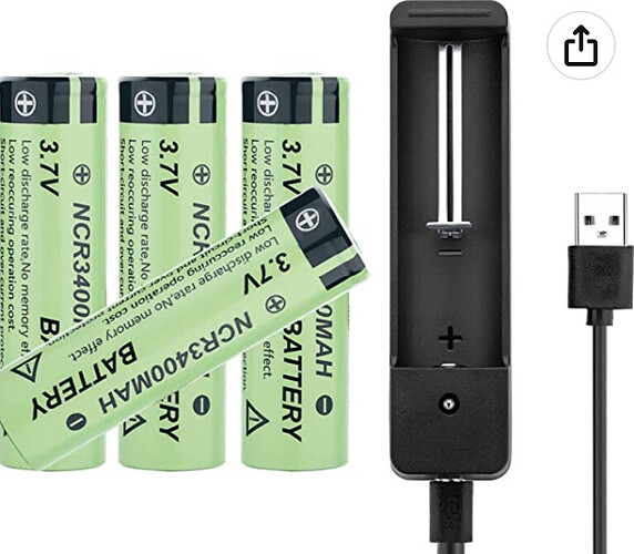

Ex: I need 3.3 Volts at 1500 mA for 2 hours. I select a Li-Ion chemistry in 18650 format (AA.) My 2 hours of On-time means I need 3 Amps for an hour.
I decide to buy this for $25 U.S.D.
The 4 cells mean that I could run my project for 4 x 2 hours = 8 hours. Or, I can just change the used battery out daily and recharge as needed on the 4th day: assuming I use the device daily.
The next issue is my need is 3.3 Volts and a full charged battery is 3.7 Volts... ummmm? Well, I have several ways of dealing with this, but the least expensive way in to put a Shockley diode in series with the battery: 3.7 V - 0.7 V == 3.0 Volts, within range of my uC.
Another way is to use a buck converter with 2 cells of 18650 in series (2 x 3.7V = 7.4 Volts) into a bulk converter and set the output to exactly 3.3 Volts. There are pros & cons to either.
You probably mean a Schottky diode.
Shockley diodes are a thing of the past.
Leo..
MS Win-11 automatic spell-checker, it does what it wants. :smiley:
18650 cells do not have an AA size, but 14500 cells have.
