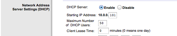

The best thing would be to check whatever it is that allocates the DHCP addresses (probably your router) and look at its configuration. There is normally an IP address that you connect your web browser to, to achieve this.
Then look for something like this (from my router):
In my case I am using the private IP range starting with 10.x.x.x, and you can see from the graphic that the DHCP server is configured to allocate addresses from 10.0.0.101, with a maximum of 50 (so the highest would be 10.0.0.150).
So in my case, I could allocate 10.0.0.160 (say) for a statically-allocated device, like an Arduino, without any possible future problems. Of course, that assumes that I don't forget, and allocate 10.0.0.160 next month to a different gadget. So some sort of manual documentation might be advisable.
