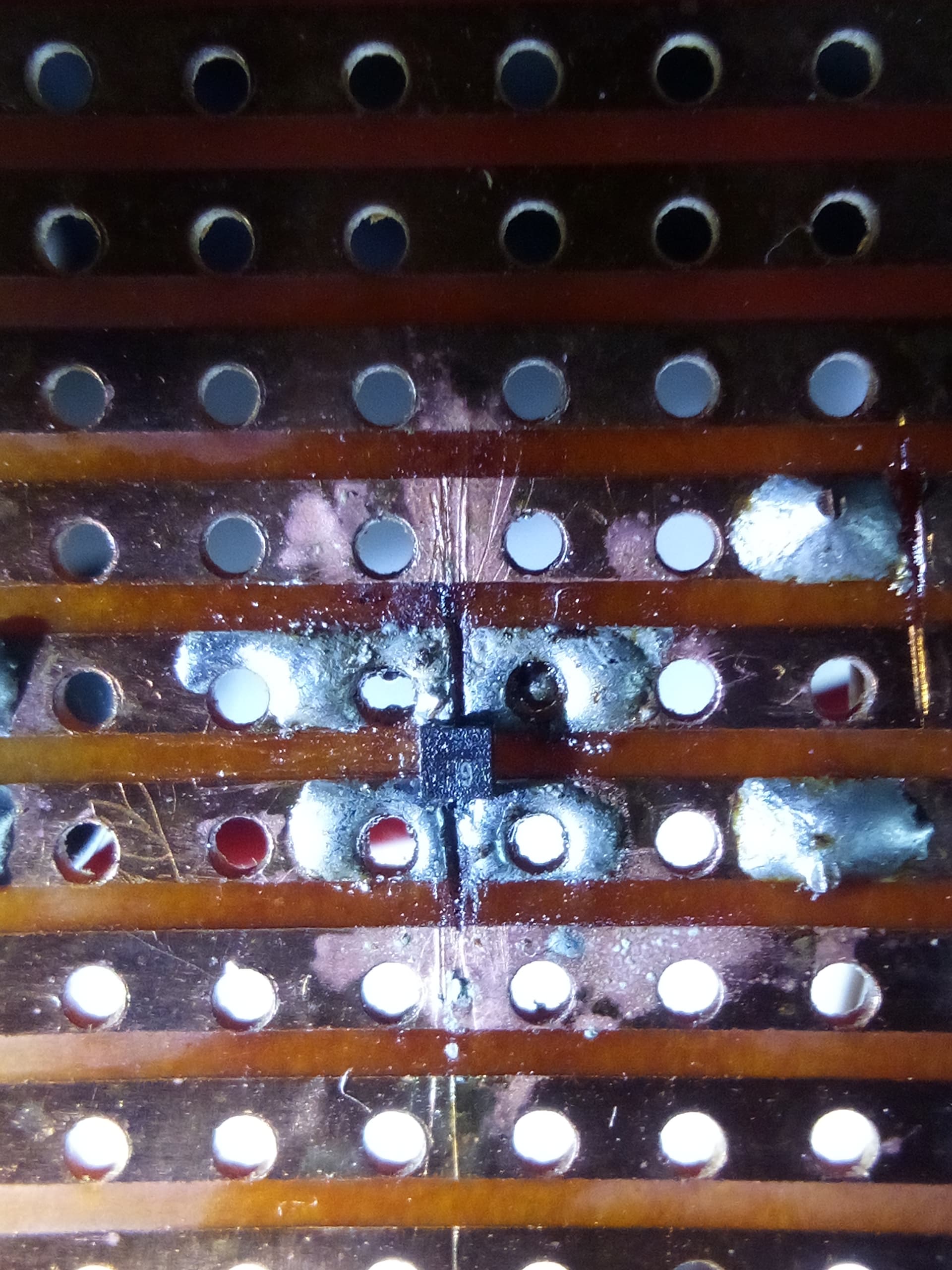

Indeed.  I was surprised at the amount of solder remaining when viewing through a 20Xlens.
I already had some but two pair of tweezers were included with the hot air gun (858D) mentioned by @jremington.
Well, here's what I achieved with my minimalist approach.
It took a bit of fussing but I was finally able to get a driver mounted – I had ordered five to allow for losses and two died in the effort. I believe it was a Celsius vs. Fahrenheit thing.  The protoboard didn’t work out because the edges of the solderable holes were too far apart for the contact pads on the chip.  I ended up using a piece of strip board, and that was barely small enough.  I also mounted a number of terminal blocks to allow different configurations as shown in the datasheet.   For reference, the holes are on .1" centers.
Is that a 4.7uf capacitor to the left with a resistor and mosfet on the right?
I use low melt solder-paste, because I was soldering SMD LED's that melt easy.
I also try to set and keep the heat just long enough to melt the paste.
You'll get better with practice, trust me. :wink:
Yes, 4.7uF, as shown in the datasheet example circuits. The other object is a flyback diode for the motor.

You really do need a breakout board to get good results imo (I might be able to help with that - https://www.tindie.com/products/drazzy/qfndfn-breakouts-from-6-to-32-pins-4-12pcs/ ).
Ideally you have a stencil and stencil the paste on heat it on hotplate or reflow oven depending on solder and components (LED beads on aluminum core PCB can only be done effectively on hotplate because the heat required to heat up the board to melt the solderhas to come from below - if it comes from above, it will melt the plastic body of the LEDs), while many other things only work well with reflow. iron is for rework and one-offs, whilw the hotplate gets used to strip boards and assemble boards with SAC305 solder,
I have found hot air to be not the most useful on it's own, but exceptionally useful with a hotplate run slightly cool to avoid discoloring solder mask, or to give an iron some extra kick
Oh and CML supply sells little bottles of kester soldering flux, they will last you years cost like 8 bucks, and the two with rosin in them (186 - a bit more aggressive, but stinkier) and 1544 (nearly as aggressive, doesn't reek). Blows every other flux I've used out of the water, and is way easier to clean off than gel flux.
As for solder paste I'd just use tin lead from china - Relife63:37, 2uul189 (its actually 182C silverbearing leaded) either of KEK's leaded solders... Avoid conduction, PPD, and Mechanic brands of paste. Mechanic's products are never above average and often below average, conductions solder paste is the worst I ever used, and PPD's only 183C solder is "S600 lead free", has shitty properties - but it still lights up the lead test swab bright red!

Here's a pdf link: https://ww1.microchip.com/downloads/en/DeviceDoc/MIC5019.pdf
Image of current mounting - showing small package size. What SMD equipment do I need? - #68 by dougp
Eeeeew....
That package is not gonna be fun to solder, you realize that right? No matter how to do it. QFNs with just a few pins and no exposed pads are the hardest parts Ive soldered (I haven't done BGAs - but 0.4mm pitch QFN20 I consider to be "not hard generally, 0.5mm pitch 48-64 pin TQFP slightly worse - both get near 100% yeild, just a matter of how much farting around with it required, and QFN's get easier the bigger they are (and hence the larger the exposed pad is - that exposed pad is your best friend, cause it gives you self-centering on any non-iron soldering method.
I'll make the breakouts - I think there's another similar package with 4 pins and just different dimensions for the back side. But they.... they are not going to be fun to solder I'm afraid.
I'll have the stencil file posted as usual by then, so you can laser-cut/beg-someone-with-a-laser-cutter/have OSHstencil make one That would make either hotplate or reflow +touchup viable. I honestly might first resort hotplate if using stencil. Though the way I'll shape the pads, it will definitely be ironable, and possibly even more easily iron-soldered than with stencil (for small quantities at least), since you'll be able to do the standard tack-a-corner-at-a-time (as you can see it's almost like a compacted QFN8, with the 2 leads in each corner combined into one - A single pad under both would I think be the way to go.
I'll extend the pads out from the corners so you can get heat under it that way, which should help. I mean, no matter what it'll still be a cake walk compared to MiniQFN 16
Yeah, I know.  It took a couple of hours experimenting, testing, thinking, destroying and grumbling to get the kludged version working.
Anyhow, I figure a board more oriented toward this part has got to be easier to work with.
