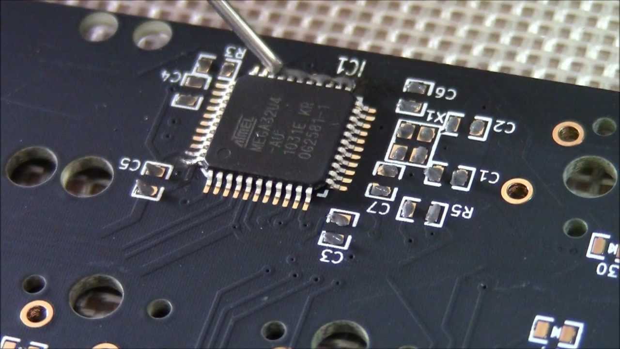

aha ok, guys can anyone please tell me what are the tools' name used in this video ? what solder is he using and how is he soldering it ?
Solder paste, soldering iron (temperature controlled), hot air soldering station.
Paul__B:
aha ! so if i wanna buy these tools are they very expensive ?
what is the solder paste do exactly isn't like the solder ? conduct electricity ?
