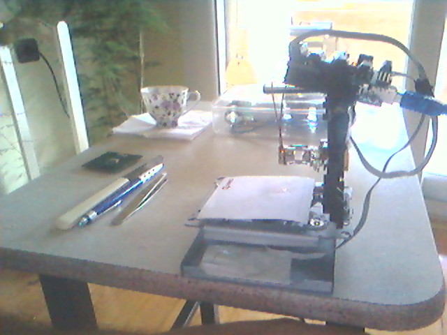

here are the photos of the cnc with a simple laser mark

I am making a 2 axis CNC as well but my Y axis stepper is over loaded , since I hacked these motors from old drives I dont have the data sheet to look at so I could check and reduce the weight on Y axis.
Would you know a supplier who sells these motors but also the datasheets please?
