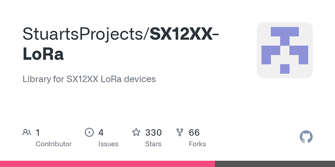

The raw image\file transfer code is published here for LoRa;
Integrating that code into a working application, where you can easily control the LoRa parameters in order to optimize transfer times is taking a while, its not ready to publish yet.
