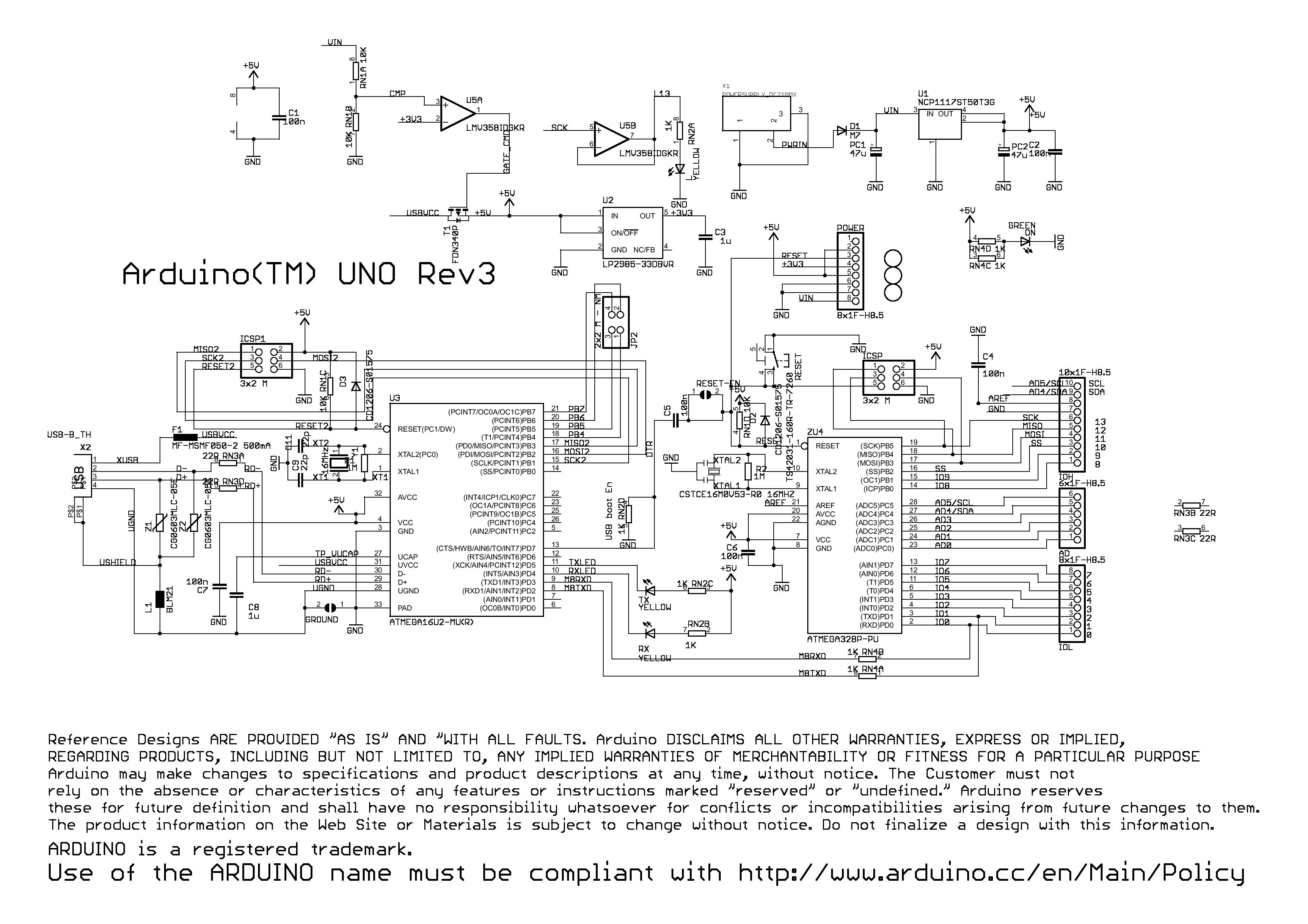

What's the dropout voltage for Uno's 5V regulator?
I want to power a Uno board with the lowest possible voltage external supply to minimize the power dissipated in the regulator and avoid as much heat generation as possible.
I'm just guessing that something between 6V and 7V would be the limit, but getting as close as I can to the absolute minimum would make me feel better.

Dropout of the 5volt regulator is about 1volt at the ~50mA draw of an Uno.
The micro/chips on an Uno should work reliably from 3.8volt.
So in theory, 4.8volt on V-in is enough to keep things going.
But at that voltage you have no regulation, no headroom, no 5volt on Aref.
6volt on V-in gives a stable 5volt rail, but still no headroom.
At 6.6volt on V-in the USB backflow protection mosfet activates.
The regulator has now enough headroom (1.6volt) to properly do it's job.
I would say a voltage of 7-7.5volt is ideal for V-in.
At that voltage everything works within specs, and you can draw some current from the 5volt pin without overheating the regulator quickly.
Max total current draw (all pins) at 7volt on V-in is about (1/(7-5)) - 0.05 = 450mA, assuming 1watt max dissipation.
The DC socket has a reverse protection diode with a 0.7volt drop in series.
Calculate accordingly if you want to use that input.
Powering the Uno via the USB socket (with 500mA polyfuse) bypasses the 5volt regulator.
Powering the Uno with 5volt directly on the 5volt pin also bypasses the regulator.

Look at the regulator on your UNO, it will very likely have a part number on it, maybe something like 'AMS1117'.
Then use a handy Internet search tool (Google for instance) to find the data sheet with a search like;
'datasheet AMS1117'
Then look in the datasheet and it will likley have a chart which tells you the dropout voltage for the current you are interested in.
There is no guarantee that each and every varient of the UNO uses the exact same regulator and as you did not say at what current you wanted to know the dropout voltage, only you can answer the question really.
