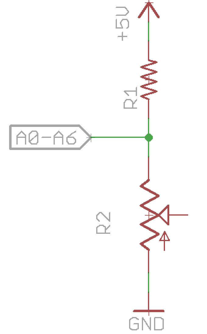

Hi everyone. I need help on how I can connect the Arduino with wheatstone bridge circuit. I had done the diagram. Hope u all can correct me if Im wrong.
And is there any program that could help me to read an unknown resistance and display it on the Serial Monitor.thank you.
Really in need of your help.

You don't need a Wheatstone bridge to measure resistance with an Arduino just use a voltage divider.
Mark
It does not make much sense to use a Wheatstone Bridge to only measure one varying resistance. 2 or more link resistor such as 2 or 4 strain gauge, That really would make the use of Wheatstone bridge shine.
for simple method, Just use a simple voltage divider such as the pic i attach below.
R1 is a fixed resistor, while R2 is the resistive sensor your trying to measure.
the value of R1 can be any value you want, but for a simpler calculation i suggest you use 1K ohm resistor.
Remember that voltage divider circuit formula is Vout = ( (R2) / (R1+R2) ) * Vin
Vout =AnalogRead( A0);
Vi = 1023;
R1 = 1;
R2 = (Vout/Vin) - 1;
Serial.print ( R2 );
Serial.println("k ohm");

If you want a temperature stable measurement stick woith the wheatstone bridge idea
The Wheatstone Bridge
The theory ... just implement the equations in C
