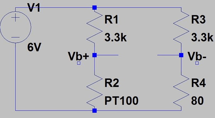

3.Is this the right circuit?
Yes much better.
OPs circuit;
So you want to measure a PT100 thermistor.
unfortunately, I have to use wheatstone bridge.
School/College class project?
What temperature range are you looking at measurements for?
Tom.... :slight_smile:
If you want to use the Wheatstone bridge to measure a PT100 sensor, it is best to use 100 Ohm, high precision, for the other resistors.

an example here
just plug the ADC in into your analog input of your arduino to read
