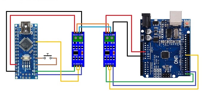

Im attempting to get two arduinos to communicate via RS485, I have a nano as the master and an uno as the slave. Im following a video that walks through it but its not working for me, ive tried several videos now. On the Nano im printing to a new line the letter A, when the letter A is seen by the Uno it should turn off an LED for 1 second. Some trouble shooting steps ive taken are making sure that every pin is properly connected and that all wries are in the correct spot. Below is my master code:

Here is my wiring diagram, note, I am not using a button, my code is basically a combo of two or more that I found online:

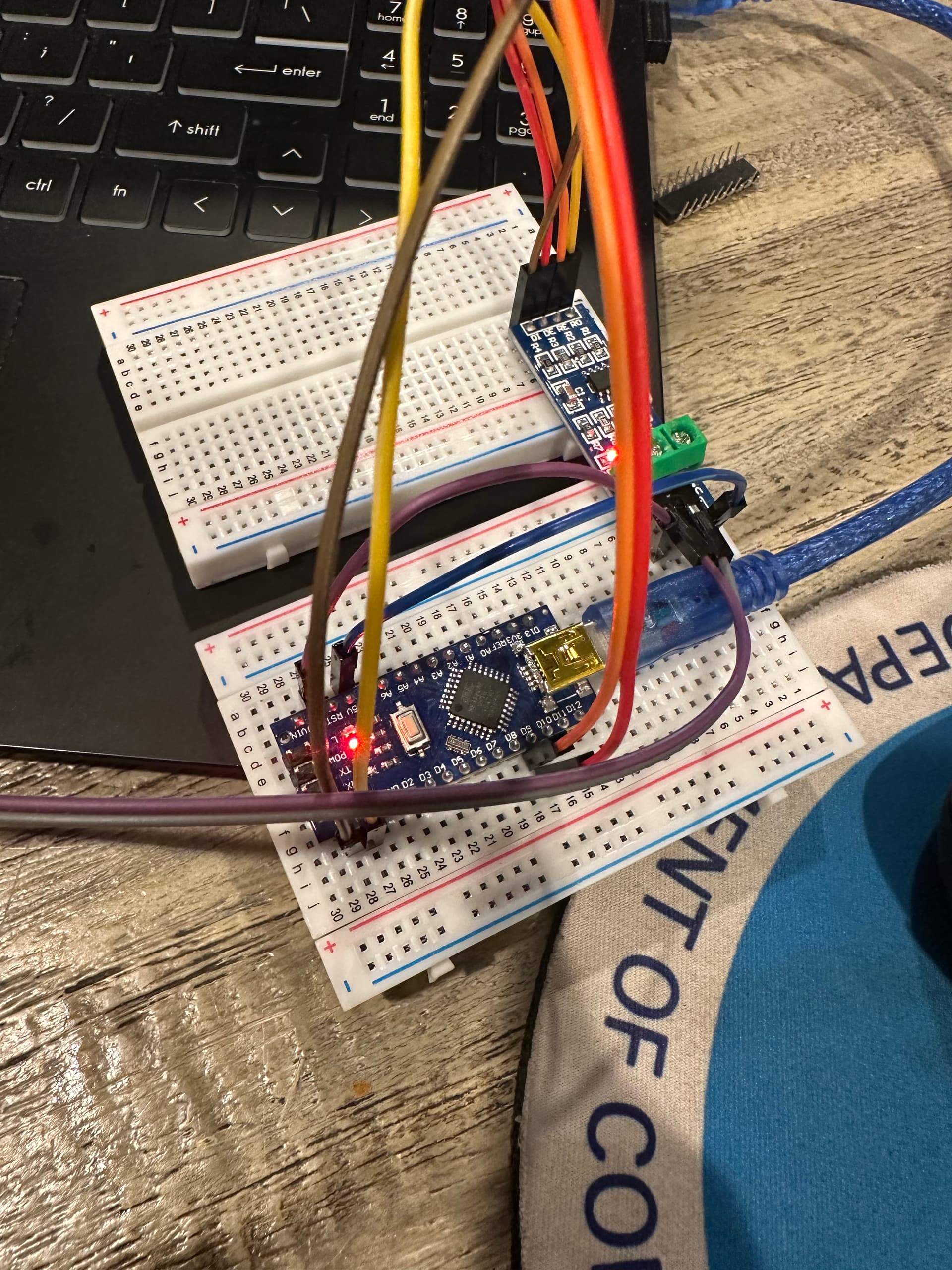

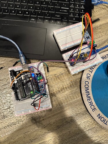

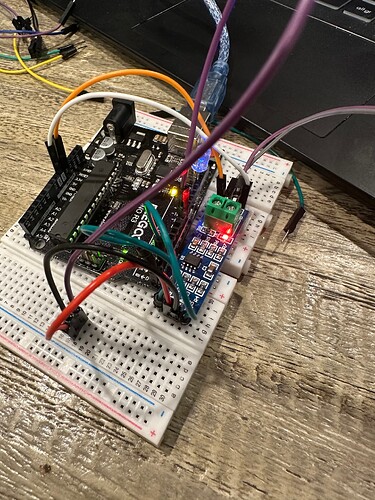

Here are a few pictures of my current setup incase anyone sees anything obvious that I may be missing:
Both:
Slave:
Master:

This sends the "A" plus a carriage return and a line feed. So, three characters. Your receive is only reading one character. Why the difference?
Try using just Serial.print('A');
In you code it's not like this. It's turning led on and leaving it on.
The GND of the two RS485 boards need to be connected together.
LED is on pin 13 NOT 12
