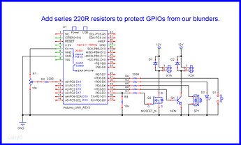

  • Before wiring and turning on the power to a circuit, I will always draw a schematic showing how I will connect the components in my project; this schematic is exactly how I will wire things.
  • I will double check that power connections are correct.
  • I will always use a series resistor of 220Ω on both Inputs and Outputs to protect my controller’s GPIO pins from my blunders.
  • I will never re-wire a circuit when power is applied.
