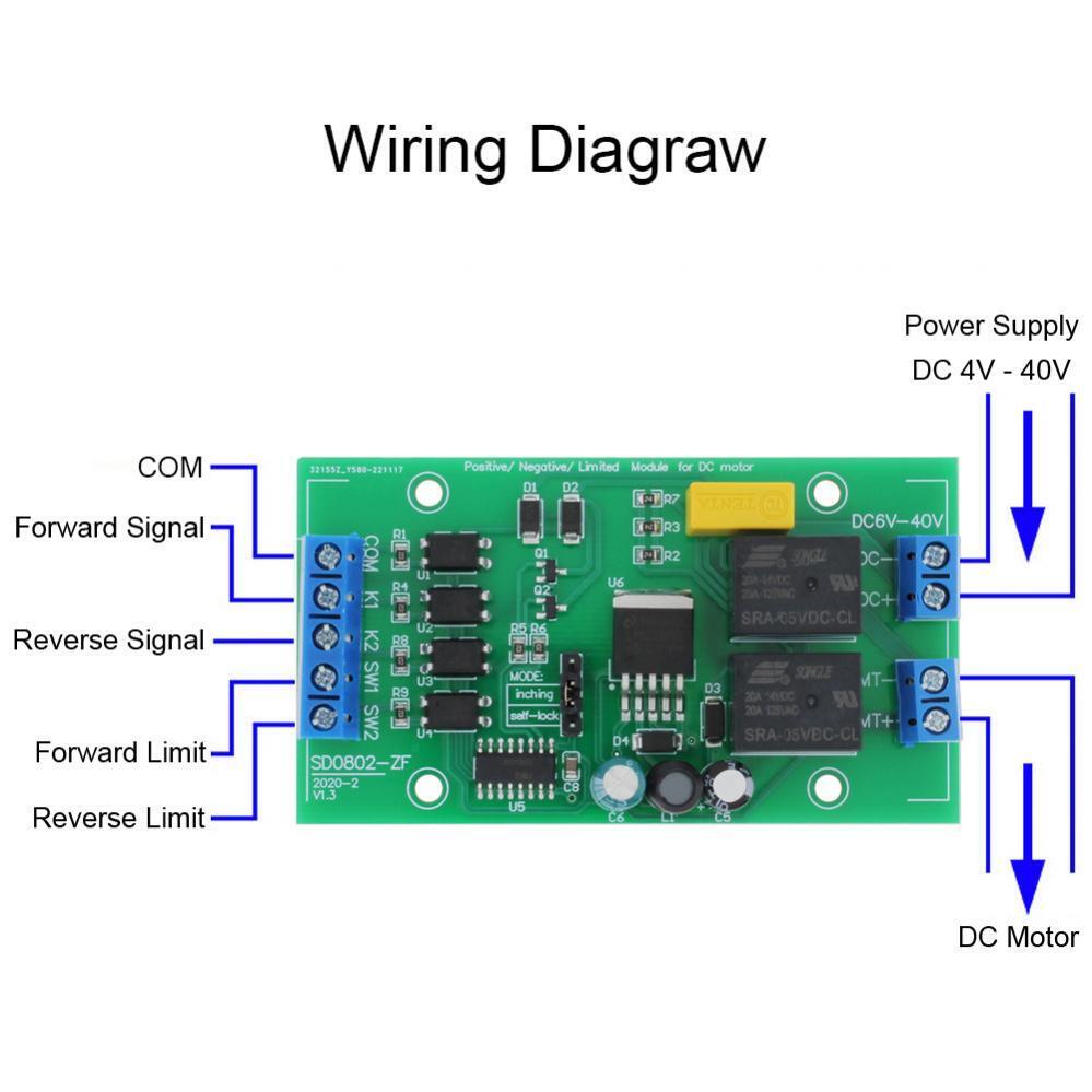

I'm a noob, with basic understanding of electronics. I am going to build a drip irrigation system for my tree nursery. This requires the ability to control several motorized valves, opening only one at a time. The motorized valve I am planning on using, requires reversal of current. I've found cheap circuit online that does exactly this:
The circuit is such, that if button K1 is pressed, it shorts the low voltage of an optocoupler to ground, and output voltage of the module is in regular direction. Pressing K2 shorts low voltage of another optocoupler to ground and output current to motor is reversed.
My first question is, how can I get an arduino to do the key presses for me?

Do you have a link to the board that would give more information? What is the voltage across K1 and K2? If it is a 5V logic level it could be driven by a digital I/O pin. What do SW1 and SW2 do?

Just use an I/O pin to connect the terminal to ground (as does the switch).
Make sure that
  1. the current to ground does not exceed the recommended maximum for your microcontroller (20 mA for the Arduino Uno, 7 mA for many others).
  2. the voltage applied to the input does not exceed the microcontroller operating voltage, usually either 5V or 3.3V.
Then I'd suggest an H-bridge (typical DC motor controller) module for each valve. If you don't want a Mega with enough pins to control so many modules, a single decoder/demultiplexer can be used to select one of the valves, e.g. 74154 as 4->16 decoder, and a single GPIO pin to control the direction of the selected valve.
The wrong voltage on the COM or switch pins could destroy the Arduino.
I wouldn't buy that board without having seen it's circuit diagram.
Unless you have the experience to produce that diagram yourself.

From this image on a $2.42 Alibaba part:
and the other images on the very same item, they all had different part numbers and circuits
In the ad's movie where the switches appear to be powered by the board, it drives a motor back and forth between limit switches:
Because the part numbers, board layouts and jumpers on the very same ad are all different, I don't think you could trust any circuit you could find. Or that you'd get parts that matched a particular circuit/picture.
Do you actually have a board where you can read part numbers? In one of the pics, the small chips looked like "817" optocouplers, but since the switches appear to be board powered, maybe the circuit is bypassing any optocoulers and supplying the key/button contact terminals from it's on-board regulator?
$2.42 is pretty cheap, but you pays your money and you takes your chance.

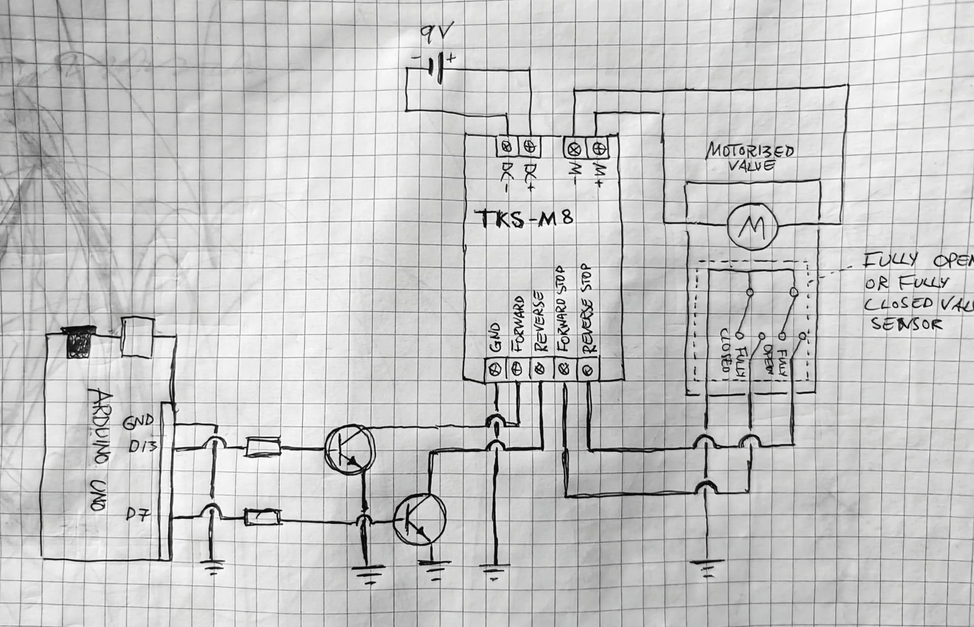

So, I decided to order some samples - a motor actuated valve and a couple of different DC reversible motor controllers.
I hooked up one of the motor controllers and cobbled together a circuit.
I used two NPN-NO transistors as switches for grounding either forward signal or reverse signal (start forward and start reverse respectively -- see post #11). I connected the gates w/resistors (don't know if it was necessary) to digital ports 7 and 13, and made a simple loop script to alternate between forward/reverse signal.
So, my proof of concept worked! There might be (or probably are) much more elegant and sophisticated solutions -- but hey, it works!
I'll need 1 digital out for each motorized valve -- i.e. 10 valves = 10 digital outs -- and one common digital out for closing all the valves, as only one valve should be open concurrently. So i.e. 10 motorized valves would require 11 pins/outputs. :blush:...
Hi, @henxan
Looks good, glad you have got a successful POC.
A schematic is worth a thousand words.
Tom.. :grinning: :+1: :coffee: :australia:
Hi, thanks!
@TomGeorge
Is this sufficient? :slightly_smiling_face:

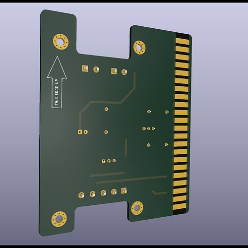

I've decided going for 2x arduino mega 2560 v.3 (One is planned as backup). I've made, and I'm going to order, 10x the following PCB I made - which specifically conforms to my cheap Aliexpress motor drivers.
I'm buying 12 cheap edge connectors which specifically suits the PCB/Card I made, and I'm starting with 6 individual drivers (maybe leaving space for 2 more for the future).
Using the edge connector card I've designed, failing units may be exchanged quicly and easily.

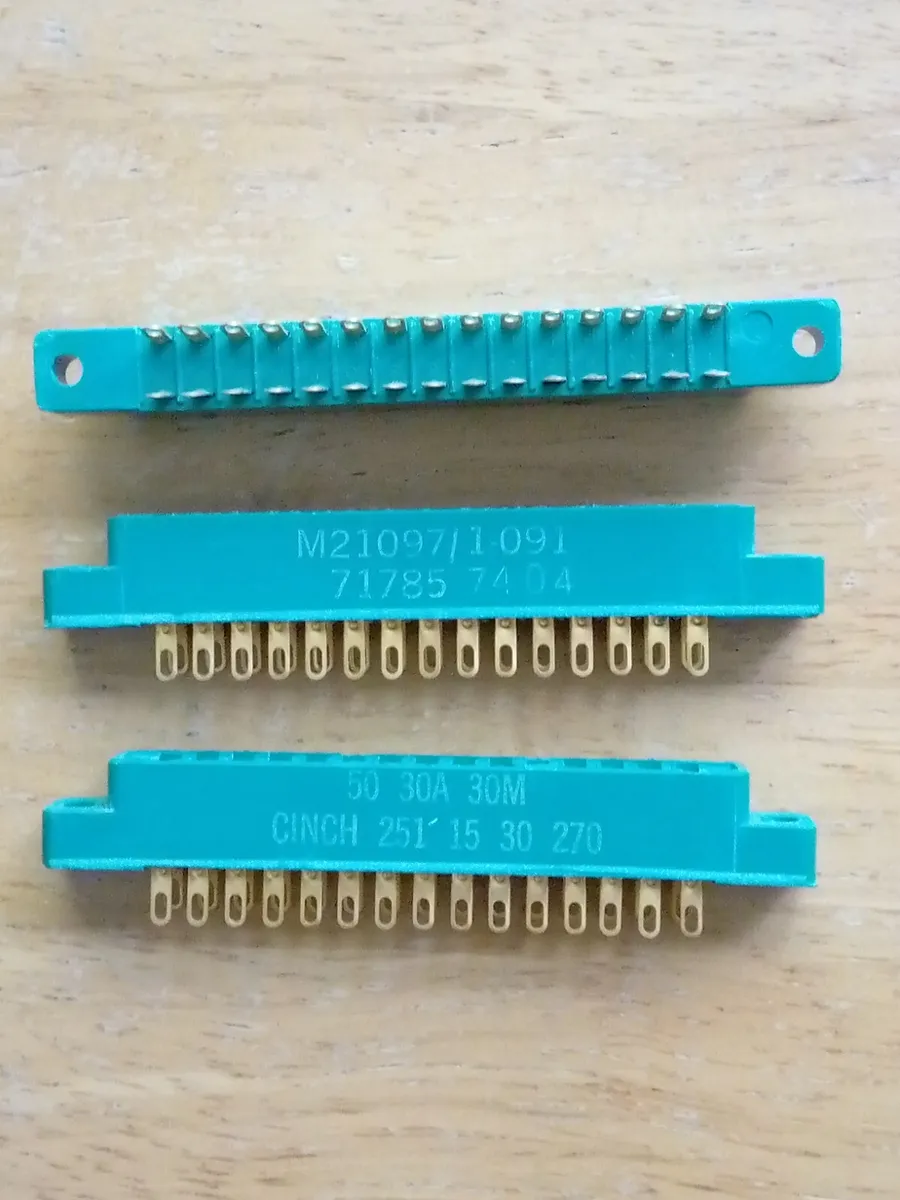

Phillips decided to produce TVs in the eighties with edge connectors, for easy module replacement. The thing that failed all the time were the edge connectors.
Leo..
Ok, but what failed? If it was the soldering between the edge connector and the board, it is quite irrelevant in this case, as I'll be using edge connector slots with screw fasteners and eyelets/wire holes for soldering - like this one.
A lot of products use edge connectors, and I believe they are pretty reliable...
Intermittent bad contact between circuit board and connector. Vibration could trigger that. Some fingers that carried current eventually burned out. Must add that the board fingers were tinned, not gold plated. Replaced maybe thousands of those edge connectors as a TV tech, only to have them fail after two years again. Then I just soldered the cards to the connectors. No problems after that.
Have a look at "screw shields". Could be a better option.
Leo..

As you may have noticed on the 3D PCB image I posted in my last reply, I had already used two edge connectors on each lead on the DC+ and DC-, and it will see a max of 0.8A I believe. This is what carries 12V. Other connectors going in and out of the board are max 5V.
However, a good connection should be maintained all over, thus I've revised my board even further, doing 2 pins for each input/output on the edge connector. Additionally, I've added a LED, such that I can see power being supplied to the board.
Btw, edge connector pins on the rear of the card will be removed, and have no function.
Edit: Btw - I'll of course be using gold plated connectors on en edge connector PCB :blush:
