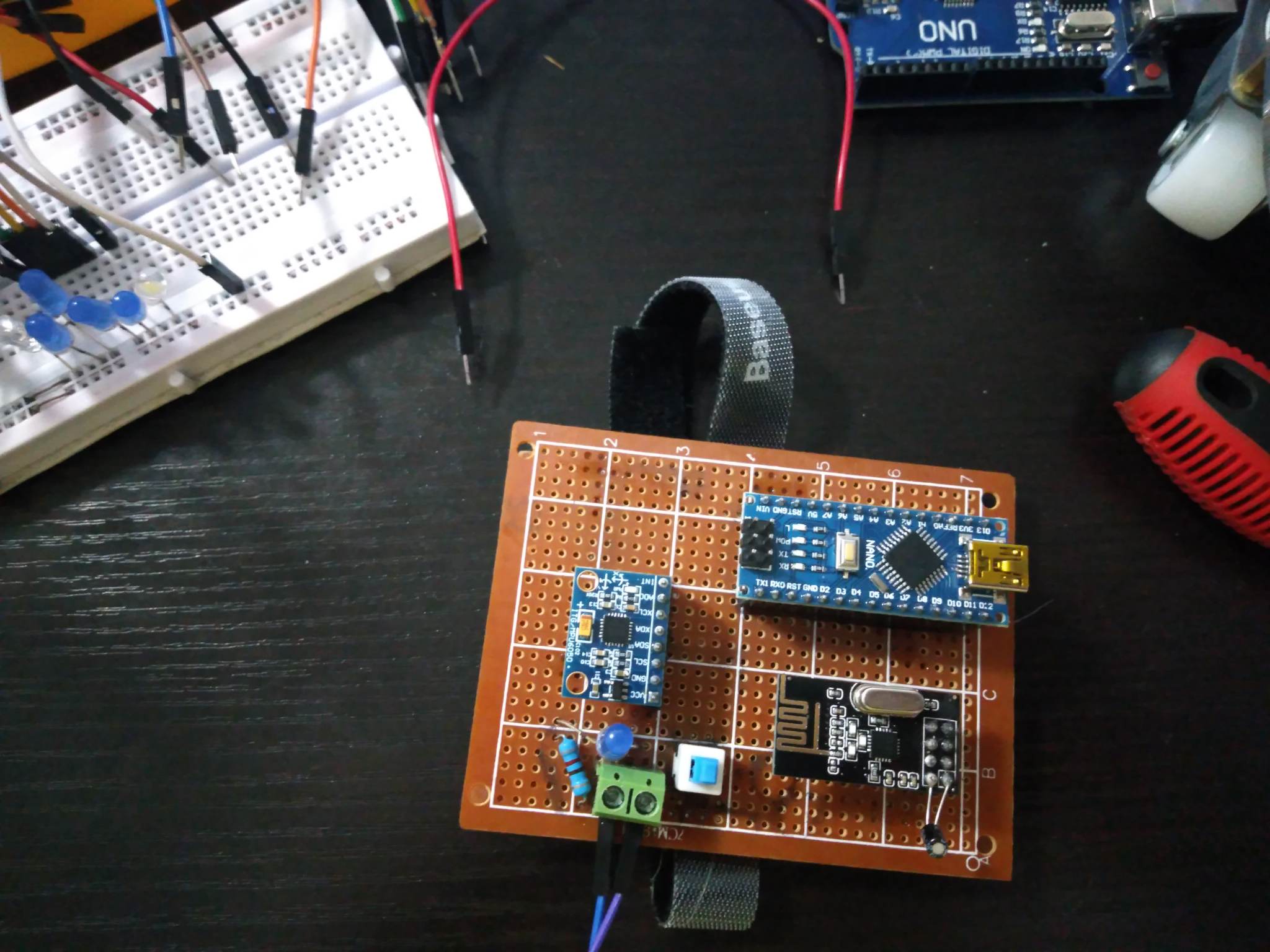

So here's the problem now. When I plug in my MPU6050, the Arduino and everything just seem to lose power. Which didn't do that before?
Did you post a schematic?
Did you post an image of your project?
The Schematic I followed
The One i made
If you are using a 9V battery like this.
Expect short run times and many issues involving low power.
I even used 9V that is pluged-in and even 12V
This is what's happening to the things when the MPU6050 is plugged-in MPU6050 Problem - YouTube
What does the blue led show? The blue led is not in the circuit.
Looks like the power is dropping out and resetting. If the blue led is a power led, then the unit is turning off and on. When you tried the other MPU does the problem persist? Check the MPU wiring? Does the MPU or other components get hot to the touch?
The circled component is the one that is heating up when I plug it in the VCC and GND. Infact, it gets soooo hot that it burns my finger.
And also I tried it in the Breadboard, and, it still happens. And I only have one, I ordered 2 but 1 only arrived.
The MPU-6050 is a 3V device, but you've connected it to 5V.
What? I should probably be reading datasheets of components and modules always. Looks like I got to buy a new one. This time, I'll buy 3... Just in case.
The chip that gets hot looks like the Vreg and its dead. Buy a new one. And I've no idea how or why it dies, I was not there to see the issue happen.
