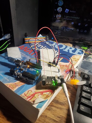

  7. Anything connected to the board? If yes, please provide a schematic / wiring diagram (photo of pen/pencil drawing is OK).
2.3.4
windows 11
ardunio uno r3
ardunio uno r3
com3
it did work in the past i don't exactly remember i think i was doing something with leds or a servo
right now a its a dc motor

Did you try with everything disconnected?
It looks like your board uses the 16U2 serial-to-usb converter (the chip closest to the USB connector). You can try the loop back test. If it fails, the 16U2 is malfunctioning.
Other test:
Press and release the rest button; does the L-LED flash quickly a couple of times? If not, the 328P is malfunctioning.
The 1st thing the loop back test im not sure if i did it right but the second part the L-Led did not flash it just stayed on. what do i do
There is not much that you can do wrong. A wire between reset and GND and a wire between Rx and Tx. Open serial monitor, type some text and it should be echoed.
Not a good sign. If the loop back test fails and the processor does not react on the reset you more than likely have done serious damage to the board.
My advise would be to buy another board.
I wonder what i did to brick it because i don't recall doing anything dangerous. but I'm new to this after all so i could have did something
