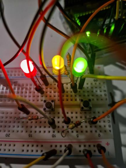

Why are these buttons not working
i have 1 that works, just these dont work and keep returning 0;
im testing this with a simple Serial.println(digitalRead(pinnumber))

here is the schematic

  1. on your first topic (https://forum.arduino.cc/t/why-does-this-always-return-1/1127539) you´ve received a tip to connect buttons using the pins on opposite corners. In the picture of post #1 this advice seems to have been forgotten.

The opposite corners advice is good advice. The buttons in the pic are smaller than are shown in diagram. If you inserted and connected these buttons with a 90° turn, instead of the pull-down pulling pin 4 to ground through the internal connection, the internal connection would connect the +5 to the pulldown resistor and pin4 would be floating or connected to +5, giving unreliable results.
sorry for the late response i was sleeping.looking back i see the colours are a little messed up in the first pic but its the same as the schematic.
2. the input pullup and removing the 5v didnt help. now it just always returns 1

If you always get a zero, that means that nothing is pulling the pin away from ground. Any 5V at the switch is not making it through the switch to the pin. Do you have a meter or probe that can measure the voltage going into one part of the switch and out of the other parts of the switch?

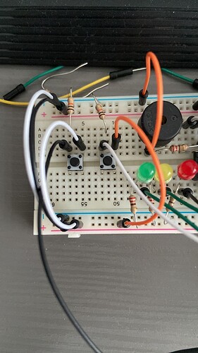

i now have the wires on the same side and it worked, thanks for the help
Great!
Please post a pic of the changed and working connections for posterity.
