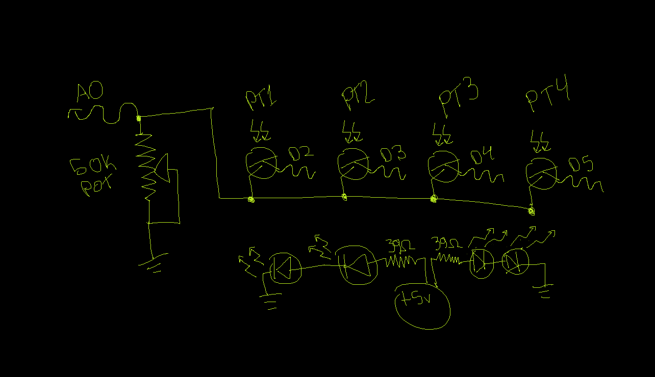

Why do photo-transistors behave normally on their own, but not when multiplexed?
I have a 4x1 matrix of infrared photo-transistors because i want to use 4 digital outs and one analog in to control it. So when i write one HIGH, read it, the write it LOW, it behaves as if it were alone an none of the other PTs where even there. But if I write it HIGH and leave it HIGH, as you might expect, the signal from that PT is also read as the signal from all the other PTs. But the weird thing is, when i do that, instead of getting a value of about 280, it goes down to 4. why would it go down so much? It's just reading the same thing as before only 4 times more frequently. And if i do it the right way, turn it off before moving on, then speed it up 4 times faster, it does exactly what it did before it was sped up. So i'm pretty sure speed has nothing to do with it. When I try to include a second one with the first, It reads zero like the others and the first one is unaffected. Same when i include all 4. The weirdest part is, the other 3 respond to change in light instead of the amount of light. Why would one be normal, and all of them normal when i switch them one by one myself, but when the computer does the changing, no matter how slow or fast, 3 lights respond only to change while the first is normal? Attached is a crude circuit diagram i drew in paint.

Smaller values on the others are slightly increasing values of the first. The faster i make it go, the second and fourth drop to lower values. then the third drops to 0 and the fourth goes up a tiny bit. What is up with this weird behavior?
It is hard to see what you are trying to do. The schematic is not at all clear. You seem to have all the transistors in parallel and there is no multiplexing going on at all.

That's what the last guy thought. The ends of the phototransistors are connected to the arduino digital pins so that they dont have a signal unless they are written HIGH. because of this i can use on single analog input for four phototransistors. This isnt multiplexed to use the minimum number of pins. infact, it uses more pins than if it weren't multiplexed. It could be 2 analog inputs and 2 digital outputs, but i set it up as a 1 x 4 matrix, using 4 digital pins and only 1 analog input. The reason being, analog inputs are limited while digital outputs are plenty. obviously i have enough analog inputs now to do it the easy way, but i plan on scaling it up quite a bit to a 4 x 85 (because i would like at least a 25% duty cycle). which would use the same 4 digital outs but 85 analog ins. im basically just staring with one piece of the matrix before i make it bigger, to make sure i can do the code first. Im switching one PT on at a time so that i can read the signal from each individually with one input. So it is multiplexed but not quite effectively yet because there will be more to it later.

What you are doing is not called multiplexing, is is known as a wired OR.
The problem with how you have wired it up is that it is all backwards. You need the emitters to go to ground and the collectors to go to the analogue input. Then you need a pull up resistor from the input to +5V.

It is acting odd the way you have wired it because of the speed that photo transistors can switch in that configuration. It would improve matters if you made your pull down resistor 5 to 10 K.

Can you post a proper schematic of what you have now. The other schematic only offered hints of what you are doing.
This might not be quite proper yet, but i spent a lot more time on this one and it's much more clear. Whatever you see, i mean exactly what is is in the link, it is exactly the same. The only difference is the resistor on the website is replaced by a potentiometer
The diagram on the website uses the symbol of an LED, but they are labeled as sensors
The more transistors you have in parallel the slower it will get due to the capacitance increasing.
What is the state of those Arduino pins when they are not selecting a transistor? Are they just an output with a zero? What they should be is to be set to an input, so they are in effect floating.
Oh, that capacitive thing explains it, i didnt think about that. I have those digital pins connected as outputs to write them high when im not reading a sensor, and low when i am, to provide a ground across the transistor while the voltage goes through the divider and into the analog input. If i set those to inputs, how do i tell it which transistor to be reading? wouldnt they just all be floating and the voltage would go over all the transistors at once?

All the transistors BUT the one being addressed should have the pins set as inputs. The one being addressed should have that pin set as an output and set high.
