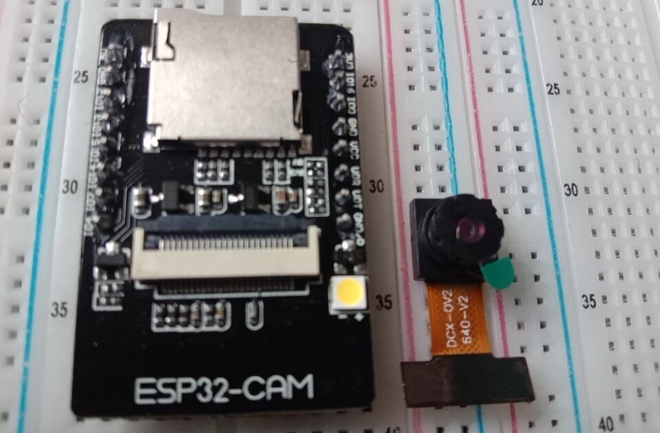

I’ve been working with the ESP32-CAM for the last three months as part of my AI-powered Cat Food Dispenser project. While examining the board closely, I noticed two additional voltage regulator ICs placed near the camera connector.
I’m curious about their purpose.
Can anyone explain why these extra regulators are included on the ESP32-CAM board? Are they dedicated to the camera module, internal logic, or something else?
Any guidance would be greatly appreciated!
Here is the schematic I found, you can see for yourself.
Some explanations say the 5V regulator is used to clean up the USB 5V. That does not compute as that is a linear regulator and needs some voltage headroom to work.
There are three regulators:
U2: 5V/3.3V used by ESP32 and Camera
U1: 3.3V/2.8V used by Camera
U3: 3.3V/1.2V used by Camera
They provide the core and analog power supplies the camera needs. Check out the camera datasheet;
