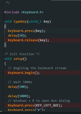

Why doesent it work
grafik
it shoud work right bc the Keyboard.h is incloudet
By "doesn't work", do you mean "doesn't compile"?
Like, maybe you've tried to compile for the wrong processor?
Please do not post pictures of code, particularly when it is only a snippet of the whole sketch
Use code tags (the < CODE/ > icon above the compose window) to make it easier to read and copy for examination
Please don't use chat speak here. It's an international forum and also it's important to be very clear because it's a technical subject.
incloudet
What is that?

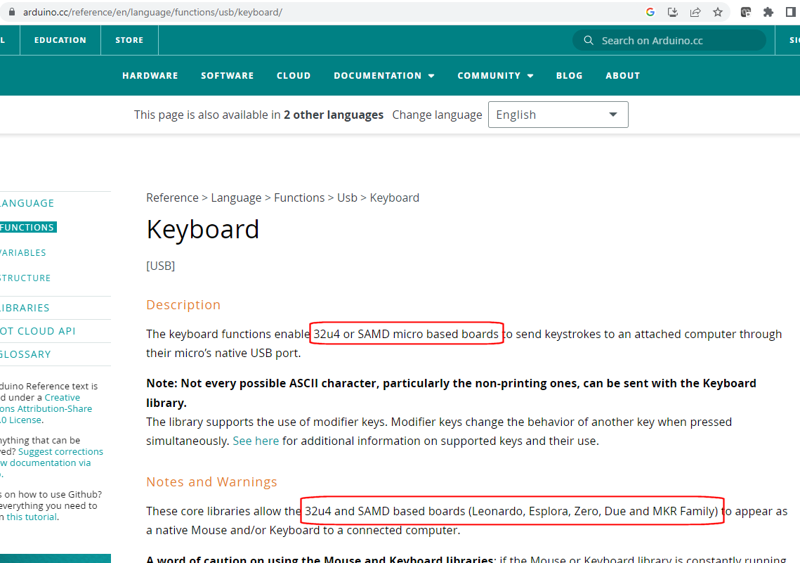

What Arduino are you using? The Keyboard library only works with processors with native USB (Leonardo, Micro).
From the Keyboard library reference.
The keyboard functions enable 32u4 or SAMD micro based boards to send keystrokes to an attached computer through their micro’s native USB port.
Images of code are not very useful. Please read the forum guidelines to see how to properly post code and some information on making a good post.
Use the IDE autoformat tool (ctrl-t or Tools, Auto format) before posting code in a code block.
Snippets of code often leave out much important information. Post the whole code or a minimal verifiable example. >> How to create a Minimal, Reproducible Example - Help Center - Stack Overflow
iam usng a one r3
Uno R3 does not have native USB so will not work with the Keyboard library.
"included" ?
Native usb isnt the pc port? Then what is? Does that apply to the mega2560?
No, boards/processors such as 32u4, SAMD21, Teensy 3.x, etc.
Does not have a native USB port either.

No - that's just a UART-to-USB converter on the Uno

"Native USB" means that the main microcontroller provides the USB functionality. So any board that has a dedicated chip (16U2, FTDI, CH340) for the communication does not have native USB.
