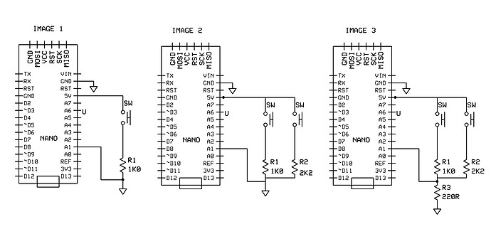

Why doesn't this simple Push Button Circuit work?
I'm trying to create a simple circuit where an Arduino can read when a button has been pressed - through Analog Input port A1 - and print the result through Serial.print().
I've been able to get the results I'm after - using a different circuit - but I really want to know why this this particular circuit doesn't give me the expected result.
Expected Result:
  • Arduino prints a value between 0 and 1023 when the button is pressed
    Actual Result:
  • Arduino prints 0 when the button is pressed (and when it isn't pressed, obviously)

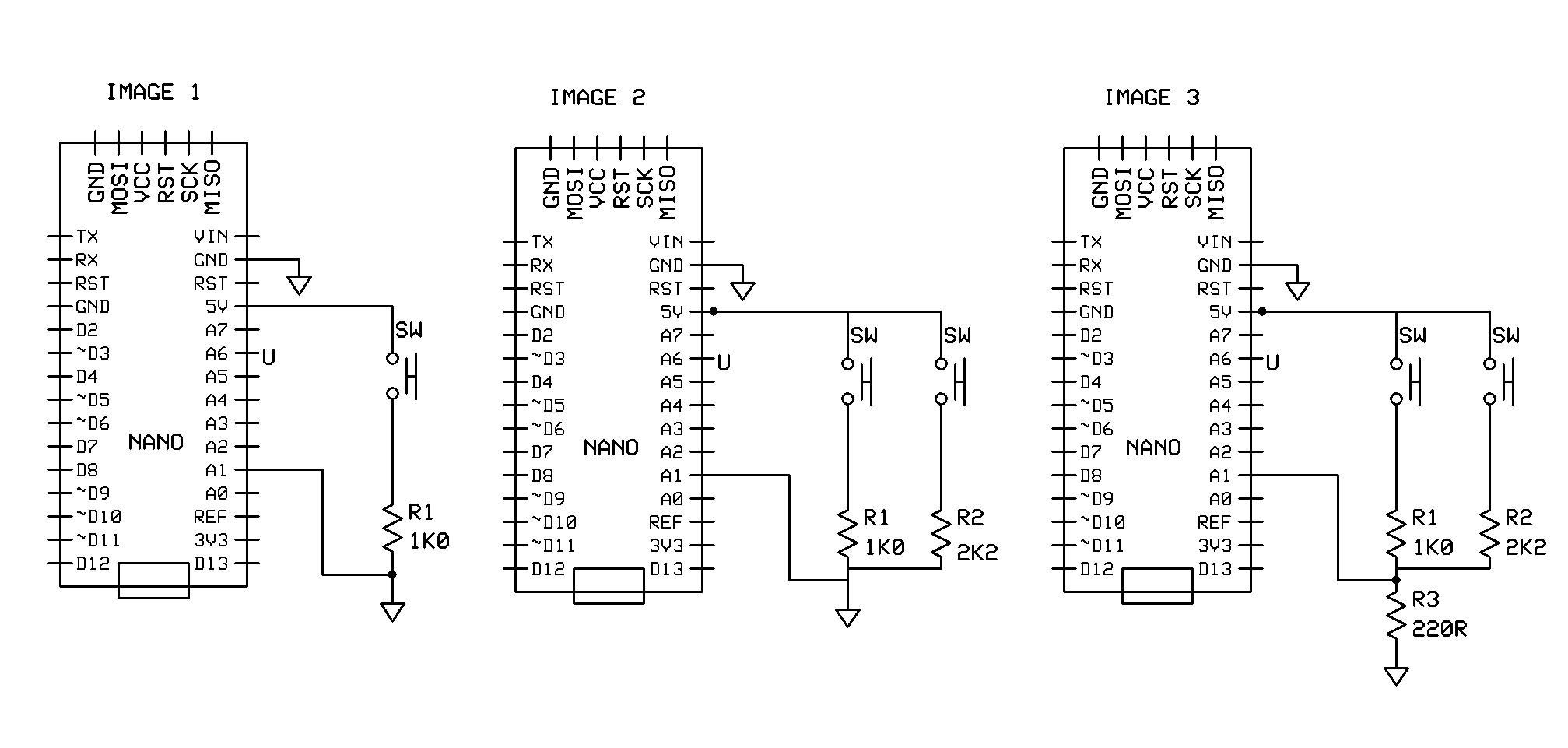

UPDATE:
I should have mentioned that the idea of this circuit is to eventually attach multiple buttons and use resistors to determine which button has been pressed - through the Analog input A1. I have attached another photo (image 2) - obviously this circuit doesn't work either. To get this circuit to work all I had to do was place a resistor to GND where all of my yellow wires meet - on the left - and remove the black wires (see image 3). What I don't understand is why the resistor makes the circuit give the expected result?
broken_circuit
broken_circuit2
broken_circuit3
How about connecting A1 to the point between the resistor and the button. (now it is just connected to GND)
So that would work - but what about when if I wanted to add another button to the circuit?

Actually, are you able to tell my why simply connecting it to GND doesn't give the expected result?
Well that would mean the resistor is between 5v and A1, which is then connected to GND. That will result in 0v
You clearly show the A1 pin connected to ground. So it will always read (near) zero.
The more appropriate way is to connect the switch between the input and ground and set the pinMode for that pin to INPUT_PULLUP. You may or may not need to add a pull-up resistor to 5 V if there is any reliability problem.
Are you able to elaborate on this a little, or point me to a reference where I can read a bit more? My understanding of how current/voltage flows through a circuit obviously needs some educating.

An analog input responds to the voltage between GND and the analog pin. If you connect the pin to GND it measures zero because there is no voltage between GND and GND.
This makes sense to me, thank you @slipstick .
