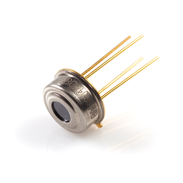

mlx90614 with Esp32-S3

I’m using an ESP32-S3 with the MLX90614 infrared temperature sensor but facing continuous communication failure. I’ve tested multiple MLX90614 modules and multiple ESP32-S3 boards. I connected the sensor using I2C with SDA on GPIO 19 and SCL on GPIO 20. Despite trying different GPIO pins and scanning with an I2C scanner, I either get no address or an invalid address like 0x7F, which doesn’t work with any example code. The MLX90614 modules I’m using already have onboard pull-up resistors. I also tried switching between 3.3V and 5V power supplies, but there’s no change in response. The sensor works fine with ESP32-WROOM and Arduino Uno, which rules out faulty sensors. I’ve even tried both Adafruit and SparkFun libraries, but still no success. Now I’m wondering if there’s any I2C level-shifting issue or timing difference with the ESP32-S3 specifically. If anyone has successfully used MLX90614 with ESP32-S3 or has insight into such issues, your help would be appreciated.

I’m using an ESP32-S3 board with the MLX90614 infrared temperature sensor (PCB module version with onboard pull-up resistors). I’ve connected the sensor to GPIO 19 (SDA) and GPIO 20 (SCL). I’ve tried multiple MLX90614 modules and multiple ESP32-S3 boards, but I2C communication doesn’t work at all. The I2C scanner either shows only 0x7F or no address at all.
