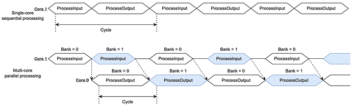

Why is multi-tasking on ESP32 dual-cores not faster than single-tasking on one core?
Hi there,

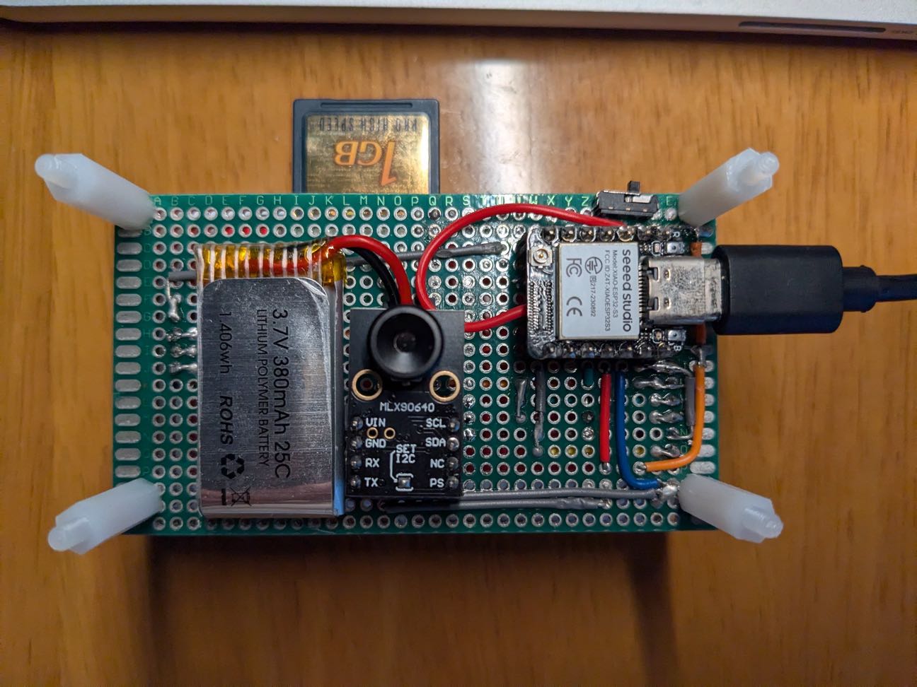

I'm now building a thermography camera which uses MLX90640, Seeed Studio XIAO ESP32S3, and 2.4" TFT LCD with touch sensor and SD card I/F.
Here is a block diagram:
1st progress
Two functions are running on the ESP32.
ProcessInput() is to acquire the thermal image sent from the MLX90640 via I2C.
And the other ProcessOutput() is to interpolate the thermal image to make resolution higher and display it in color.

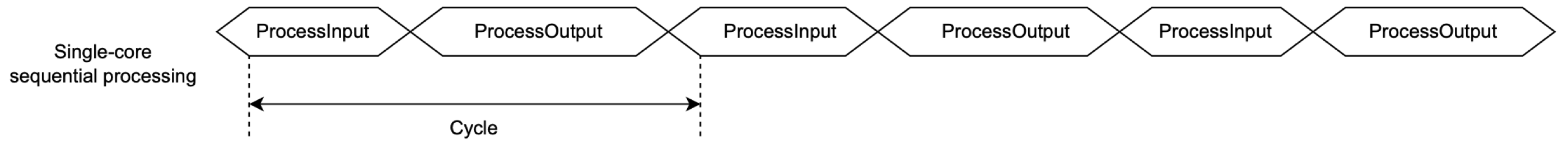

These functions run sequentially in loop() on ESP32 Core 1 and everything works fine like as follows:
2nd progress
So as a next step, to speed up the frame rate, I rewrote the program so that ProcessInput() runs on core 1 as Task1 and ProcessOutput() runs on core 0 as Task2. And those are connected with double buffers and some synchronous handshaking.
The handshaking between two tasks is using a message queue and a counting semaphore. The expected effect is expressed in a timing diagram as follows:
(Edit: Added "Core 0" and "Core 1" to each time line.)
(Edit: If you can not understand my poor diagram, please refer to Multiple buffering - Wikipedia)
I think it will be easier to understand if you actually see my program, which I will show it at the end.
Result
When running on multiple cores, I found that the processing time of ProcessInput() increased, resulting in no improvement in frame rate at all :face_with_raised_eyebrow:
ProcessInput() [ms] ProcessOutput() [ms] Frame rate [Hz]
Single-core sequential processing 74 52 7.9
Multi-cores parallel processing 127 53 7.9
Note that 7.9 โ‰’ 1000 / (74 + 152) in the 1st column, and 7.9 โ‰’ 1000 / 127 in the 2nd column.

What is the timing of ProcessInput() in a multicore setup, while not running the output task.
If the input process is blocked by the output process the time should be near 75 ms again.
If you have two cores both trying to access the same output pins then it will take just as long as one core accessing those pins sequentially.
You will only see a speed up if each core accesses different hardware resources.

So I think that after the first xTaskCreatePinnedToCore() execution the Task1 is immediately activated. Then Task1 execute ProcessInput() like as follows:
void Task1(void *pvParameters) {
  uint8_t bank = 0;
  while (true) {
    uint32_t start = millis();
    // some process
    Process1(bank); // <-- **ProcessInput()**
//  Serial.println(millis() - start);
    bank = SendQueue(bank, start, millis());
    TakeSemaphore();
So the ProcessInput() must run at first, then ProcessOutput() runs. And I observed my simple sketch before combining with other staff such as MLX90640.

Yeah I see! Two cores access not the same output pins but internal memory (in PSRAM?).
ProcessInput() in core 0 is always access I2C to get thermal image and output to the internal memory (which consists two banks), and then ProcessOutput() is access the internal memory to interpolate the thermal image and output to the LCD through SPI.
Therefore, one possible cause is the competition on the internal memory, which will not be improved by giving task 1 a higher priority than task 2.
I wonder If core 1 and core 2 compete on the memory bus, which one will have priority?

Why is there the number 4 near the hatch mark of the I2C Bus -- when the I2C is a two-wire Bus?
The ESP32S3 has a shared data bus for both cores to access the same RAM โžœ while both cores have independent instruction caches and their own local registers, they share the access to the system's memory, including both internal and external RAM and when two cores try to read from or write to RAM at the same time, the access must be serialized. This means both cores can experience contention when accessing memory (and also the caching mechanism could lead to bottlenecks).
there is info in the graphic
OP counted the power wires.
Hi @GolamMostafa ,
Thanks for checking the diagram.
I intended SDA, SCL, Vin and GND.
Sorry if this is confusing.
You need to put semaphores around all shared resources (HW and in memory etc).
And yes, multicore does not always result in faster execution.
Fortunately the ESP32 can do I2C an other pins, so one can create an I2C bus per device (at least to a certain level)
Do we consider the power lines (Vcc and GND) as the signal wires of the I2C/Two-Wire Bus?
That's right. Thank you!
that's not the topic of this conversation... Really I'm not a hardware guy, so I don't care much about any conventions on such high level drawings... I take that for what they mean, 4 wires going from the ESP32 to the module...

The XIAO has a battery management IC on board, so the prototype camera looks like the one in the photo.
I'm not really sure how to read the spec of Li-Po battery, so I'll check it again, including the current consumption of the MLX40960 and the LCD, along with the current supply capability of the XIAO.
