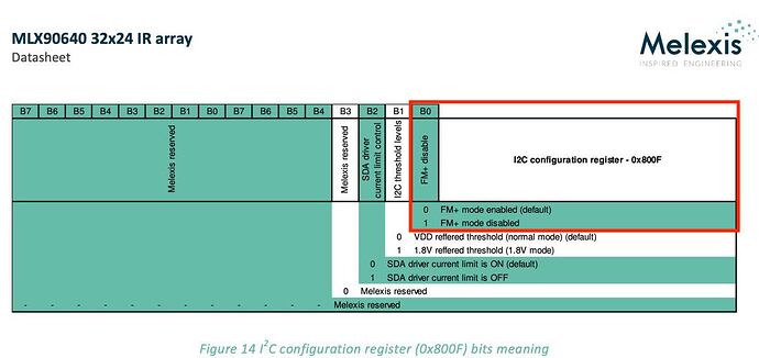

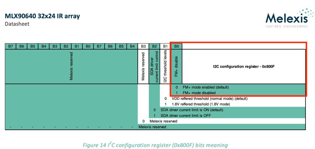

I2C slave: MLX90640
The default I2C bus speed of MLX90640 is Fast-mode plus, i.e. 1Mbsp.
I2C master: ESP32S3
The ESP32 S3 datasheet states that the I2C bus speed is up to 800Kbps.
And the actual code is limited to 1Mbps by i2cSetClock(), so we cannot set it higher than 1Mbps.

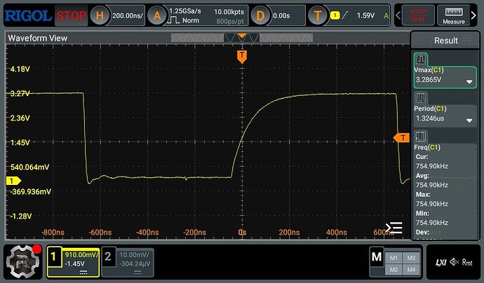

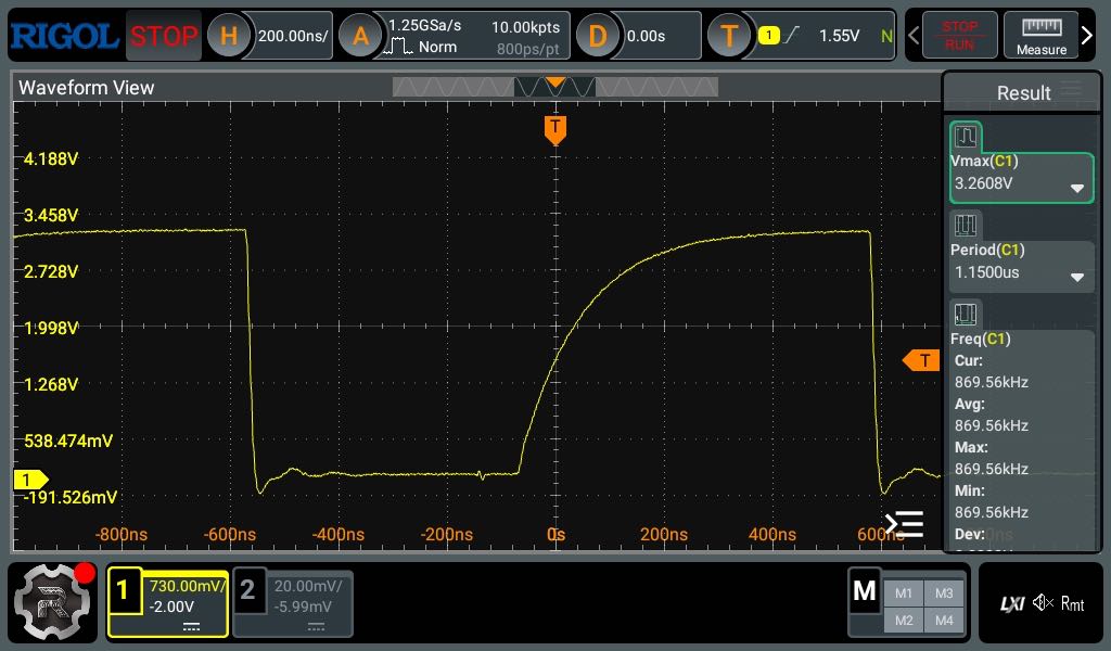

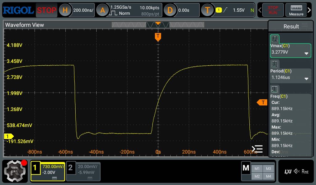

I set the I2C bus speed to 1Mbps on the master side. Here are the results:

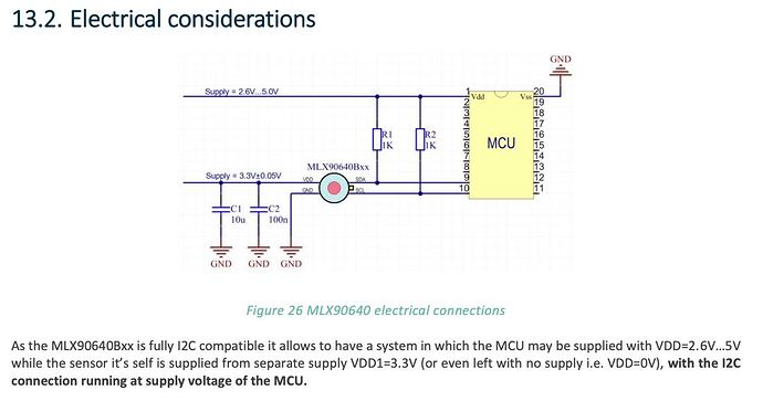

For 1KΩ, I referenced the following recommended circuit from the latest data sheet. (As an aside, when I looked at this circuit diagram, I assumed that the MLX90640 breakout board had a pull-up resistor built in, which was my mistake.)
The waveform when I specified 800KHz with a 1KΩ pull-up resistors was as follows. Observed frequency is below 800KHz.
What I can see from these results is that while the MLX90640 on the slave side has plenty of power to spare, the I2C clock is limited by the ESP32S3 on the master side.
At first I thought something was wrong because the waveform was so dull, but I left it alone without looking deeper.
First I need to develop my experience-based intuition to recognize that something is wrong. Secondly, I would like to develop the ability to dig deeper to find the cause.

The pull up resistors in a system can be distributed, that is spread over several devices. Some times with some boards you get say a 10K on each board. These resistors work in parallel, so two boards with 10K on each board will give you 5K, which is just about right for a standard 5V pull up. Although you can half that resistance and still be within specification.
When I worked in industry it was standard practice to use only one pull up resistor for the whole bus. This is because while each resistor might only cost $0.001, when you are making a million boxes this is a substantial saving to use only one.
The 3V3 systems have a standard pull up of 1.2K.
The wave forms should be as close to a rectangular wave as possible, but the wiring layout, if not done correctly, or is extended over the design distance, which is about half a meter, capacitance issues can slow the working of the bus.
Your first waveform dump is an appalling shape, any would send any engineer looking to fix it. The squarer they are the better. That last picture looks pretty good and would be no cause for alarm.
